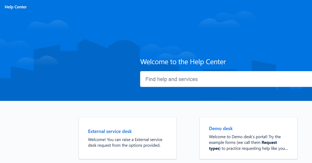

There shouldn´t be anomalies in users and roles: I am Admin, and the external guys are set up as agents.
However, as I also set them up as customers, their landing page is the help centre, from where they can only raise requests, but don´t have the standard agent view.snap.PNG

What is the configuration that you have in permissions?
If you give them the URL of service desk queue, what do they see?
Best regards.
Daniele Meoni
December 4, 2019
It says that the page is not available.
I think I can actually deal with the customer view, as I´ve changed permissions (thanks for that ;) ) and now works fine.
