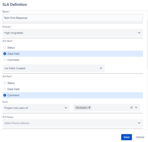

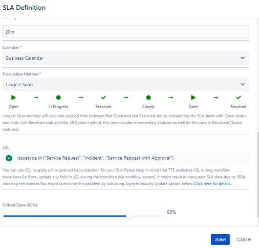

"For Tech an issue with High priority should be responded within 20 minutes and solved within 1 hour"
  • Create your calendar
  • Setup an SLA with the following parameters:
Priority: High
SLA Start: Date- Jira field - Created
SLA End: Status or In Progress (you can customize this accordingly)
SLA Goal: 20m
JQL: issuetype in ("Service Request", "Incident", "Service Request with Approval")
For your Time to Resolution for Tech team, Just clone this SLA, change the SLA End: Date Field: Resolved or Status: Done (You can adjust this accordingly) and SLA Goal: 1h.
for the content team an issue with High priority should be responded within 30 minutes and solved within 2 hour.
For this requirement you can clone the first SLA (Tech - High Priority), just change your SLA Goal to 30m and 2h for Content - First Response SLA and Content - Resolution SLA respectively and change your JQL to issuetype = Problem
and that's it!
Your last requirement: "Is it possible to exclude the others SLAs whenever a Problem issue type is raised." You can achieve this by adding issuetype != Problem if you have any other SLAs that Tech and Content team SLAs.

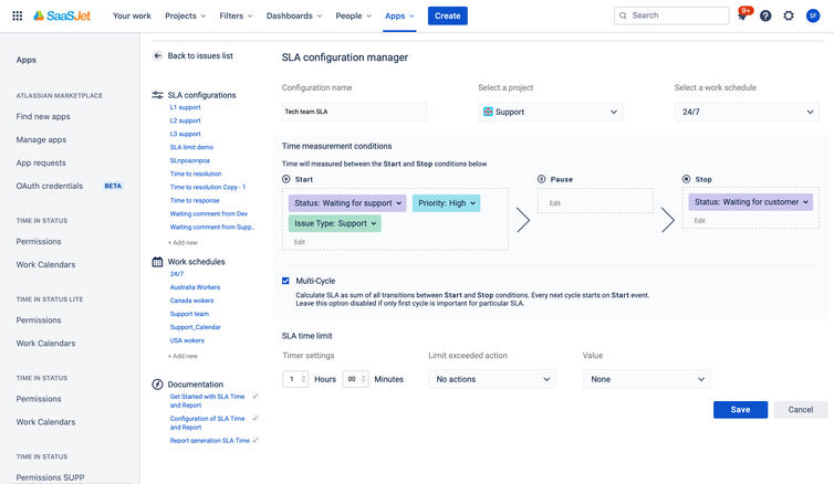

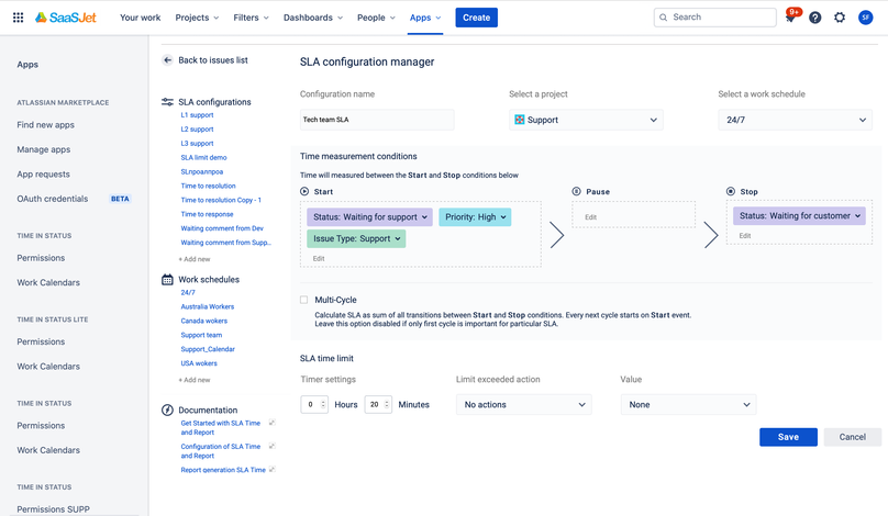

Hi @Brian Gitonga
You can consider solution from Atlassian Marketplace like SLA Time and Report.
It lets you resolve this case by creating 2 SLA time configs.
For the first case, you can use such SLA conditions as st the screenshot №11 case.png
Then save and copy this Config for the next case. But in the second case, you will need to turn on Multi-cycle option and to change the time limit.
So you will have 2 Configs and will track the information you are asking.
Hope it helps
