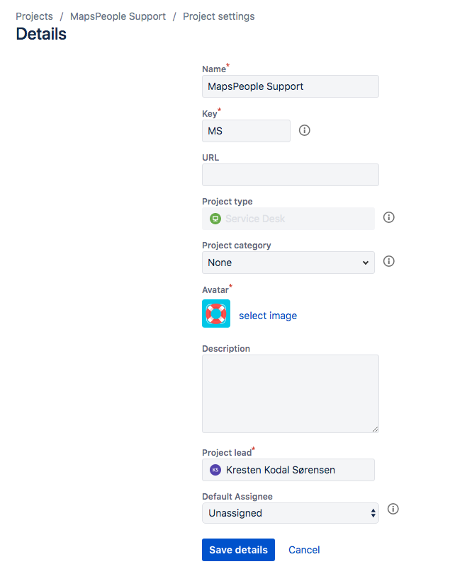

I did try this and changed the Project Lead to my own account.

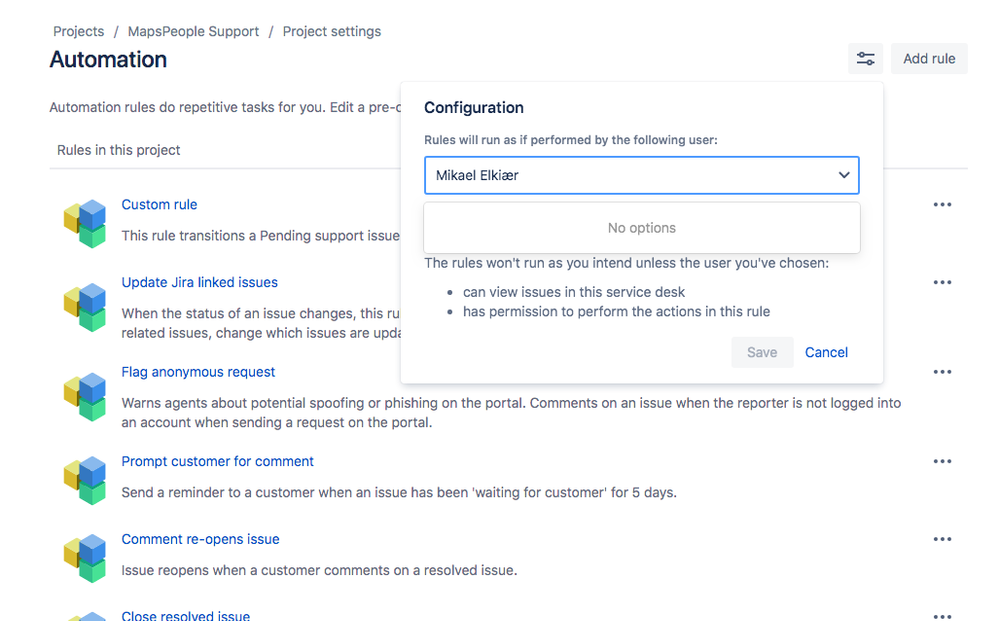

But still the in the Automation setting I am only able to select my former colleague who originally created our service desk project.

Hi @Kresten Kodal Sørensen
On that Automation configuration page, add your cursor to the front of |Mikael and start typing your name. Only a few letters needed for it to appear or a list of names to appear.
I think there is a bug in the Configuration screen Rules will run as if performed by the following user.
Save when done.
-Mike
