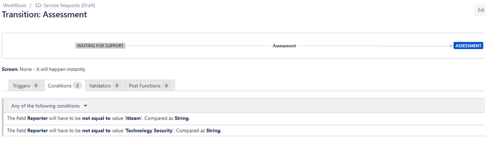

I have setup conditions on my workflow so that a user cannot transition when the Report = 'itteam' or 'Technology Security', but my tests all let me transition with those values in place on the Reporter field.
Any idea why the workflow is ignoring the conditions?

Using a condition in this instance and setup is correct for the requirement. But the condition was failing because it was set to 'Any of the following conditions', instead it should be set to 'All of the following conditions'.

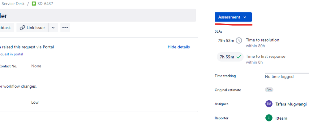

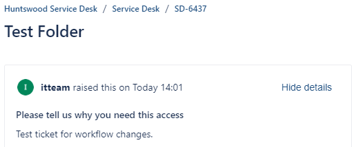

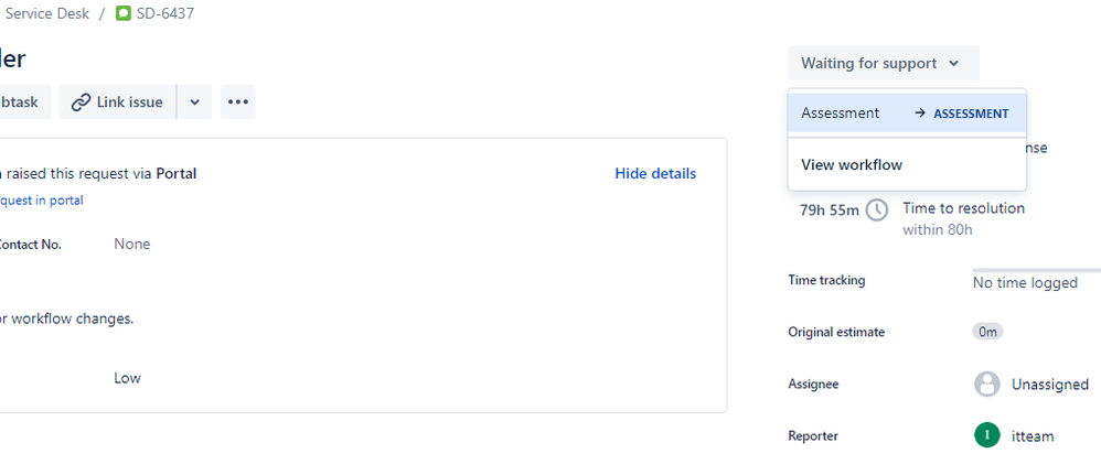

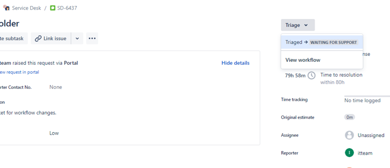

Tafara Mugwangi
March 10, 2021
Hi Jack
I thought so it should work. I'm not sure what else to show so I have just took some screenshots along my etstign journey. I had previously published my changes but did it again just in case. See attached.
Jira SD Workflow Conditions.pngJira SD Workflow Status.pngJira SD Workflow Test ticket Workflow Option 1.pngJira SD Workflow Test ticket Workflow Option 2.pngJira SD Workflow Test ticket Workflow Transition Wrongly Passed.pngJira SD Workflow Test ticket.png

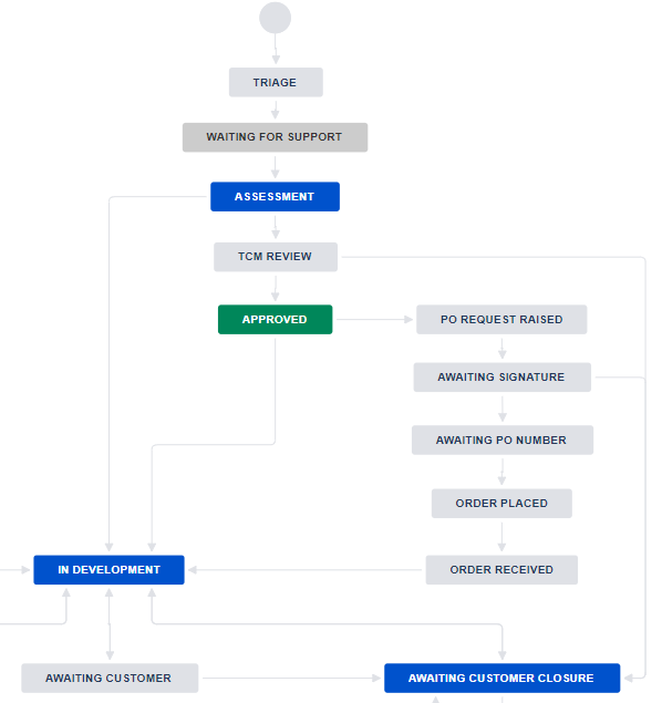

Tafara Mugwangi
March 10, 2021
Hi Jack
There are no other transitions into Assessment other than the one I covered. I have added an image of the workflow. Jira SD Workflow.png
Jack Brickey
March 12, 2021
I'm missing something here...
You OP has an image of a transition (Start work) from Waiting for support to In Development. This is where you have your conditions. However, the workflow is not illustrating that transition at all. Unless the line are hidden. Later you are showing the transition (Assessment) going from W4S --> Assessment with those same conditions. Which transition are you wanting the condition on and are you sure you have things setup as you want, have published the latest updates and are testing in accordance w/ the latest published WF? If so then I'm unsure where the problem might be. I might suggest you try a test project and WF and see if you can get the logic to work to assess if it is something unique w/ this project/WF or systemic.
