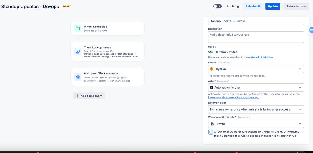

Mohammed Aamer Khan
May 14, 2024
Hi @Priyanka
Can you please provide screen shot of rule you have created so that I can help you with resolving your issue

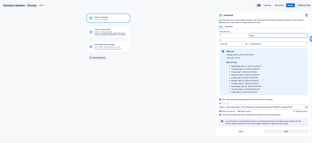

Mohammed Aamer Khan
May 14, 2024
@Priyanka
I don't see any problem with Automation, Can you please share Screen shot of Trigger item details. I have attached below for referenceTrigger item.png

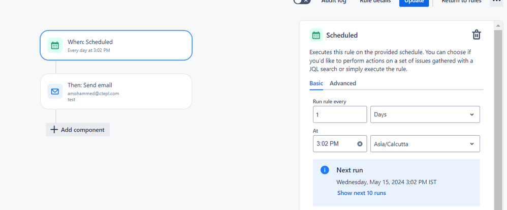

Mohammed Aamer Khan
May 14, 2024
Hi @Priyanka
I see that you have selected a checkbox
"Run a JQL search and execute actions for each issue in the query"
Due to this it is executing rule for every issue. Please uncheck it. You will get desired result.

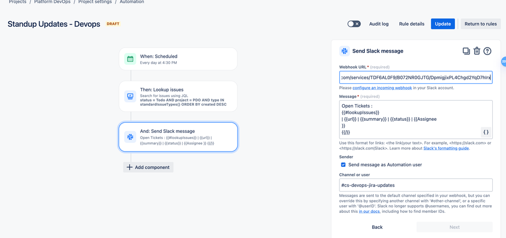

Joseph Chung Yin
May 14, 2024
@Priyanka -
Can you confirm on what is triggering N-numbers of time?  The Slack message?
The rule itself will only fire once at 4:30 on a daily basis based on your configuration scheduled.
Please advise.

Priyanka
May 14, 2024
@Mohammed Aamer Khan Please find the screenshots
