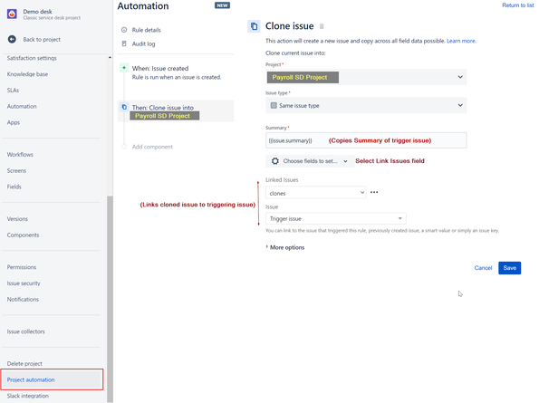

@Aaron Pieros To add to what Jack said, you're probably looking for the Project Automation section rather than Automation. Take a look at the below for how you could set the rule up in the HR Project's settings, give me a shout if you have any questions! Hope this helps
