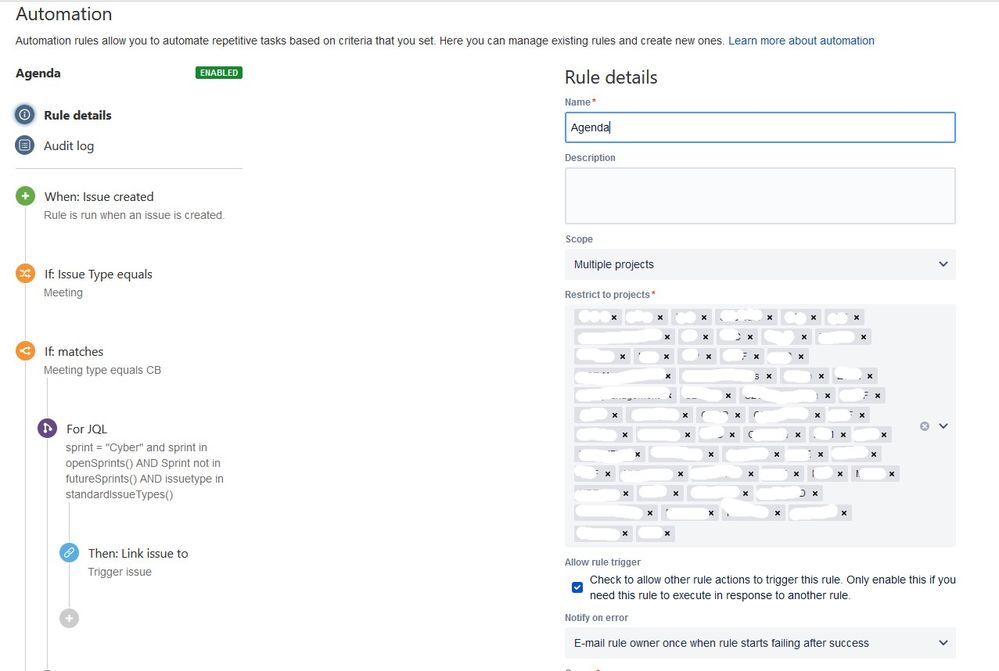

We use several automation rules in the "Global" application but restrict them to around twenty projects out of a total of more than 800 projects. During the execution of this automation, it runs only on a single project, which is not the first in the list and, moreover, without making any intervention. At least for this particular project.
Where could the issue be located regarding the fact that, during the execution of the automation, it runs only on a single project, even though it is assigned globally but restricted to about 20 projects?

Here a screen shot of the scope and a step in it. This step is "if in customefield (Select list) is"
I've just mask the name of project for security reson.
The step when it's trigged, create a sprint with correct name and with a message on comment to notify the beggining of this sprint soon. and link all necessary (if 0 then no attachement) sub-task to the issue.

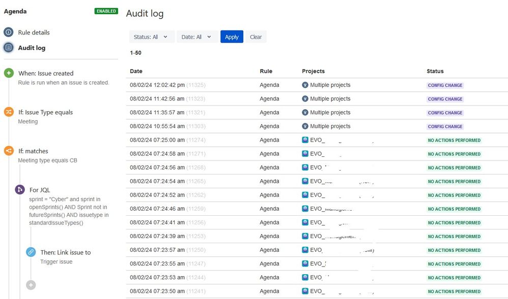

What does the audit log show on the no actions performed?

So based on the log action.

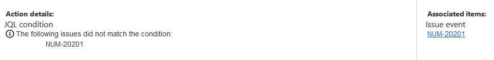

An issue was created in project NUM, the project is in the scope, otherwise the rule wouldn't have been triggered.
The issue created NUM-20201 doesn't result in TRUE on the JQL condition, so the rule doesn't comply for issue NUM-20201 and therefore no action is performed.
This is exactly the action and response that is expected from your rule.
