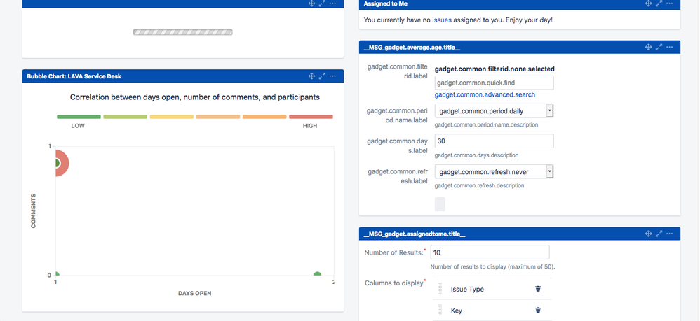

@Stephen LoeckleI get that message too, however are your gadgets name displaying properly? Please check because in mine they don't. My problem is that I need to install Apache so that we can configure SSL.
Stephen Loeckle
January 17, 2019
There are a couple that do but the rest do not
Like Tinker Fadoua likes this
