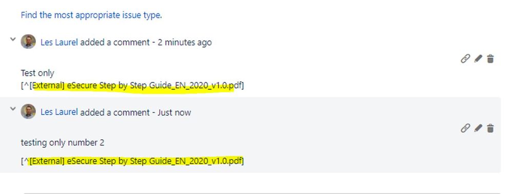

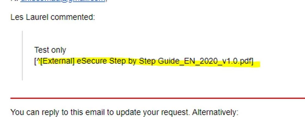

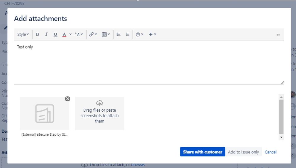

I uploaded a PDF file to the portal with success. However, when I share file  as comment or attach in new comment, it only shows file name and no files attached. I created a test ticket.

The issue is rectified. The cause of the issue is due to the file name with [ ] as per my previous screenshots. It's treating it as a command. I renamed the file by removing [External] and it works! Thank you for your inputs.
