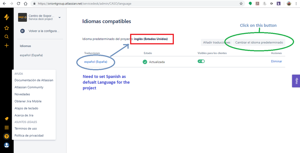

I want to change the default language of a project:

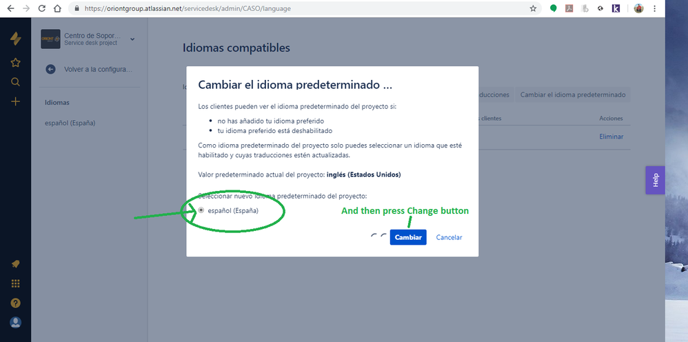

After that, I choose the desired language:

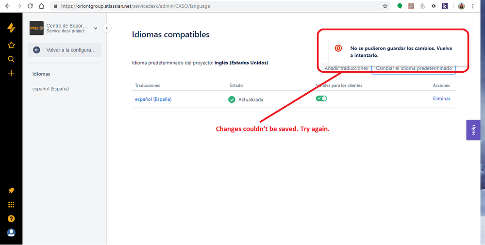

Finally, I get "Changes couldn't be saved. Try again" message. I did this step in severals opportunities, and every time get same error.

Richard Skopal
May 15, 2019
Hi,
I had the same problem with default language change "Changes couldn't be saved. Try again" error. I looked at the saving POST request (e.g. https://mytestweb.atlassian.net/rest/servicedesk/lingo-integration/1/manage-language/10002), its result status code was 500 with this error message: " FD-86: Failed to copy translations of project 10002 from Lingo to original table: This issue type cannot be changed because the issue type on which this issue type is based was removed. To restore the issue type, add back its associated issue type in the issue type schema in this project" (translated).
So I added all previously removed unused issue types back to my project's Issue Type Scheme and then I was able to successfully save the project's default language change. After the change I removed the unused issue types from the Issue Type Scheme again.

Jeroen van der Veen
June 4, 2019
Thanks Richard!
This worked for me, temporarily adding all the available issue types and then I was able to change the default language.
