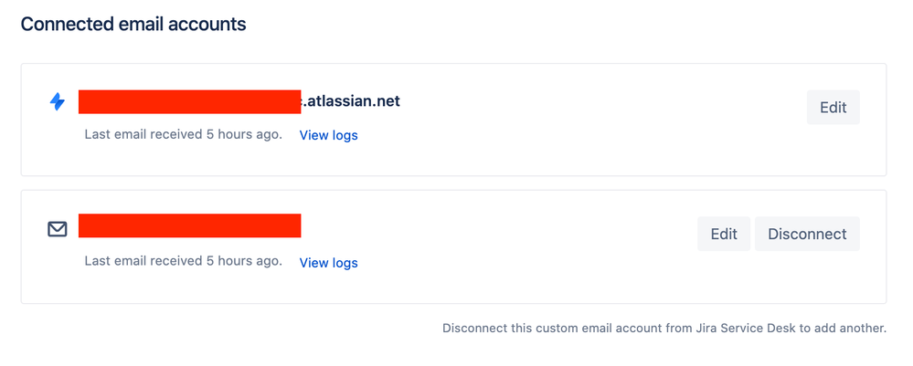

I use default settings for Service desk and I have just set the custom email for requests:

so one thing that stand out to me here is that both the Atlassian provided email and the custom email appear to be active. They both indicate last email received 5 hours ago. Is it possible that the email to create a new ticket is being sent to both? Can you please click View logs on each and interrogate?

Hi Jack, I have checked the logs and I found the problem. There was forgotte redirection rule on the custom domain for our old account.
Solved :)
