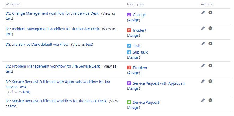

David Gage
November 30, 2018
Jack Brickey
December 2, 2018
Thanks. As I suspected. It seems to me that what is missing here is automation of the move component. So I think the automation needs to look like this...

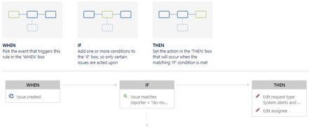

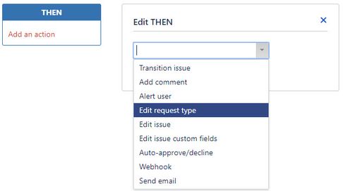

David Gage
December 3, 2018
Jack,
   I apologize for sounding like a complete muppet, but I'm not understanding how to make that work.  I created the Request Type: System Alerts and Errors (Incident).  And I can't see how to change the IssueType to Incident from the Automation rule set.
Sorry for spamming the images... hoping this will help figure out the problem.

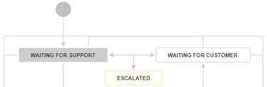

  • Service Request starts with "Waiting for Support"

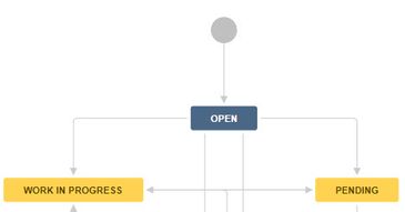

  • Incident starts with "Open"

@David Gage, to be clear are you trying to change the "issuetype" or the "request type". I'm reading both terms in this thread and as a result I think I have been mixing my answer. :-(
I think you are trying to change the issuetype but for example in your automation screen shot (Tuesday) you are referencing the "request type" which is altogether different. With the native automation, you can change the request type (as you have seen) assuming it exists for the issuetype. However, I cannot find an automation "Then" action for changing the issuetype. There is an Edit Issue but the issuetype isn't in the list of editable fields that I can find.

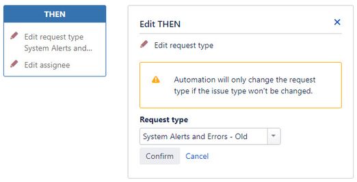

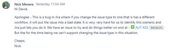

What I want to change is the the Issue Type, but the only way I can see to do it from an automation rule is to change the Request Type (which has a different Issue Type associated with it).  Of course, I'd like the Request Type to change too, but the priority is to have the Issue Type changed.
I noticed this when I was looking through the Automation rules.  I'm guessing this is a telling detail, but I'm not sure how to decipher it and what it means as to why my automation rule doesn't work.

@David Gage, With the native automation you can only change the Request Type (RT) not the Issue Type (IT). Further, as the error is trying to convey, you can only change the RT if the new RT is associated with the current IT. If you want to change the IT you may want to try Automation for Jira or Automation for Jira Lite (free - 300 automations/mo).
Here is an example that I hope will explain the error message you are seeing.
Let's say you have the following situation:
Issue Type "ABC" with these Request Type: apples, bananas, oranges
Issue Type "DEF" with these Request Type: apples, pears, grapes
So, if an issue is created of Issue Type "DEF" w/ Request Type of grapes and your automation wants to change:
  • RT to apples then it will succeed because apples is associated with the current "DEF" issue type. however...
  • a change to bananas would fail because that RT is NOT associated w/ the incoming IT
I hope this makes sense. I believe we have fully dissected this issue at this point.

Apparently, Automation Lite for Jira cannot do this either.  I although I was able to get the rule to run, there's a bug in the process that removes the ability to update the status.
The only fix I could find was to move the ticket to another type (eg - Type:Project) and back into Type:Incident.  Which is to say, not what I want and defeating the purpose of "automating" the change.
I'll keep looking for other tools that might do the trick, but until then... I'll uninstall it and do things manually.
