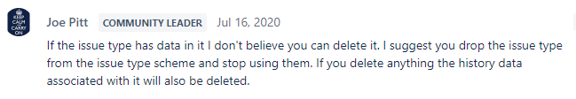

Thank you for the quick response. I looked around some other posts and found this suggestion that I will test.
I am not looking to completely remove the type but just disable it from being selected as a type when creating a new ticket while retaining the type for the older tickets that are remaining in the project.
Hi,
Joe's suggestion isn't any different. His first sentence is correct - if you have issues of that type in the project, you won't be able to delete the issue type from the scheme unless you migrate all the existing issues to another type.
