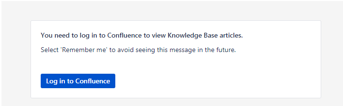

Hi there,
We have 50 employees that I want to set up as customers on the JSD. As we are using Active Directory, I just set up the AD sync and am Synching to JIRA and Jira is linked with Confluence, so all the users show up on confluence as well.
All our setup is on internal Servers, not on the cloud.
According to the documentation, I should be able to have the IT team and a few other users to manage the confluence pages and give all the users access via the JSD with one only login prompt, using AD credentials.
Currently, I'm able to login with a customer on the JSD, I can see my service desks I can search articles and raise issues, but I cannot open the article itself, it says I need to login on confluence to see the article.
Although I've been looking online for a solution, I wasn't able to find any meaningful justification for this behaviour. The only thing that works as a workaround is configuring the confluence space as anonymous access, but that is not an option, I've just done that to see if it would work and it did.

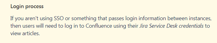

I guess that this is an issue with the "common user base" of JSD and Confluence. Follow this link to set up the KB successfully.

The only dodgy statement that I'm not sure due to its ambiguity is this one. Does Application Links in JIRA classifies as "... something that passes login information..." between Jira and Confluence? As this is the only bit I'm assuming so...

But when you login to Confluence as a customer , you can see the article, right?
Jose Q
February 12, 2019
Hey @Thomas Deiler
Yes, that is right. With my customer account, I have access to it. I was actually not expecting that, I thought I had to really access that page via the JSD window.
If I click on the login button it opens up a new window with confluence and if I log in again I have access to that page.
Is that supposed to be the intended behaviour of JSD?
Thomas Deiler
February 13, 2019
Yes - that's the design. If you want to skip that second login step, you need to implement SSO.
