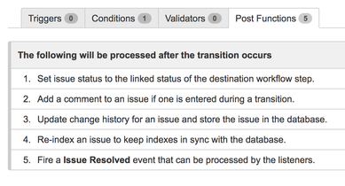

You'll also want to check that the workflow transitions to Resolved include an Issue Resolved event (step 5 in screenshot) in their postfunctions.

In the workflow transition, already exists the step "Fire Issue Resolved"

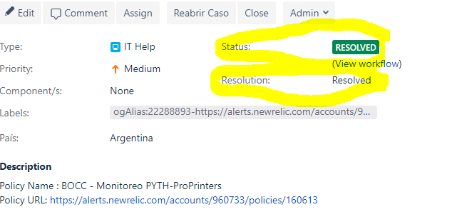

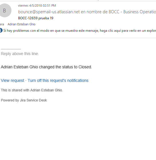

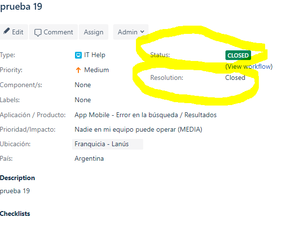

And I can say that Resolution IT IS SET. as you can see in capture 2 and 3.... for example.... I didn´t received the customer satisfaction of any of them (take a look to the capture 4 and 5)
As I said, the STATUS (workflow) could be RESOLVED, CLOSED or CANCELED
and the Resolution could be: DONE, RESOLVED, WON´T DO, REJECTED, and any other.... (Resolution is never EMPTY if STATUS are RESOLVED, CLOSED or CANCELED)

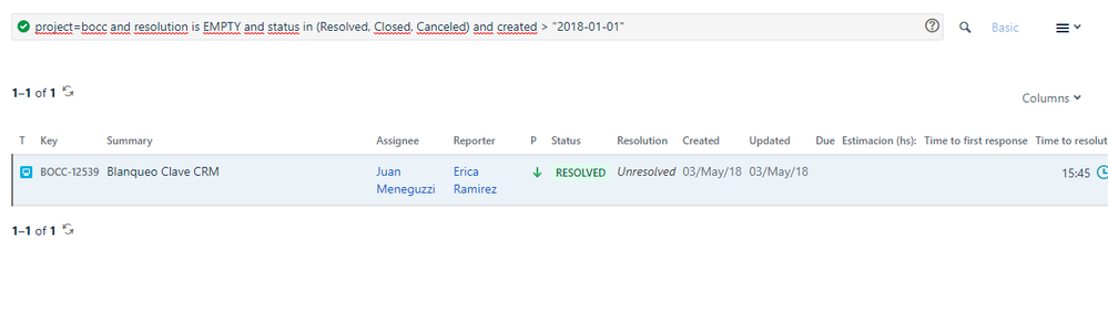

@Meg Holbrook, thanks for your help.... As I said, I understand the difference between "status" and "resolution".... As you can see in this picture, There are only one issue, wich we used to testing....
In fact, The workflow has the post function: "update issue field resolution to: Resolved"Captura6.PNG

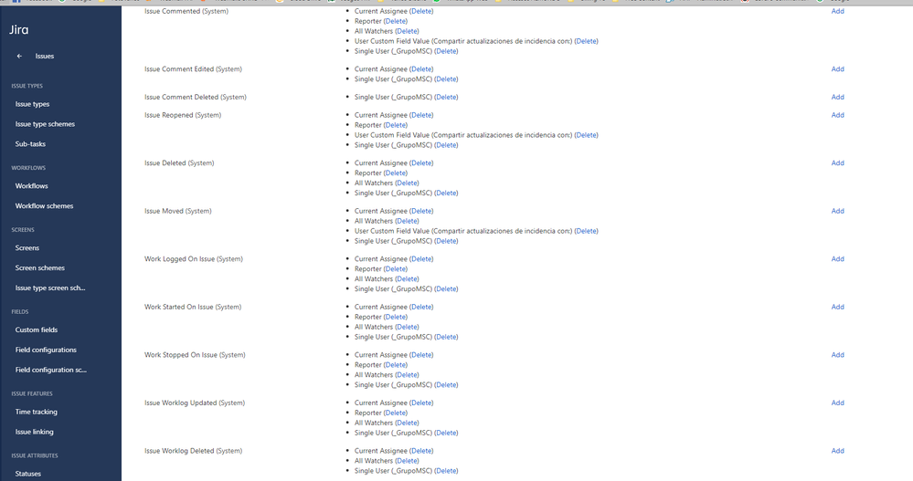

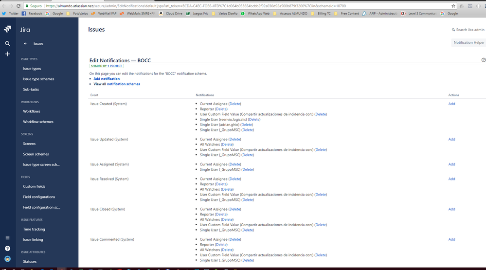

here you can see the notification settings for this project (called BOCC) in a notification scheme called BOCC too
(hope it helps, and let me know if you need anything else....)
