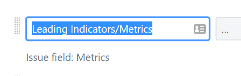

First, is "Which service do you need access to? (If you do not see it here then we do not look after it!)" the actual name of your field, or is that the label you've given it in JSM? You can check by going to Project Settings -> Request Types, then choosing your request type and clicking into the Request Form view. From there, click into the field to see the back-end field name. In my example, the "label" is Leading Indicators/Metrics, and that's what customers see on the form. But the actual field name that Jira sees is just Metrics, and if I were writing JQL, that's what I would use.

I was initially trying to create a report under the New Report option but this wasn't useful for what I actually needed. I moved to Jira issue searching as needed to create a dashboard but still came across the same issue.
I realised that the field label was what i was using, so have renamed the field itself (for ease) and the JQL I was using above has yielded results!
Thank you so much, I never would have thought to check that myself and will keep notes of this in the future.
