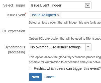

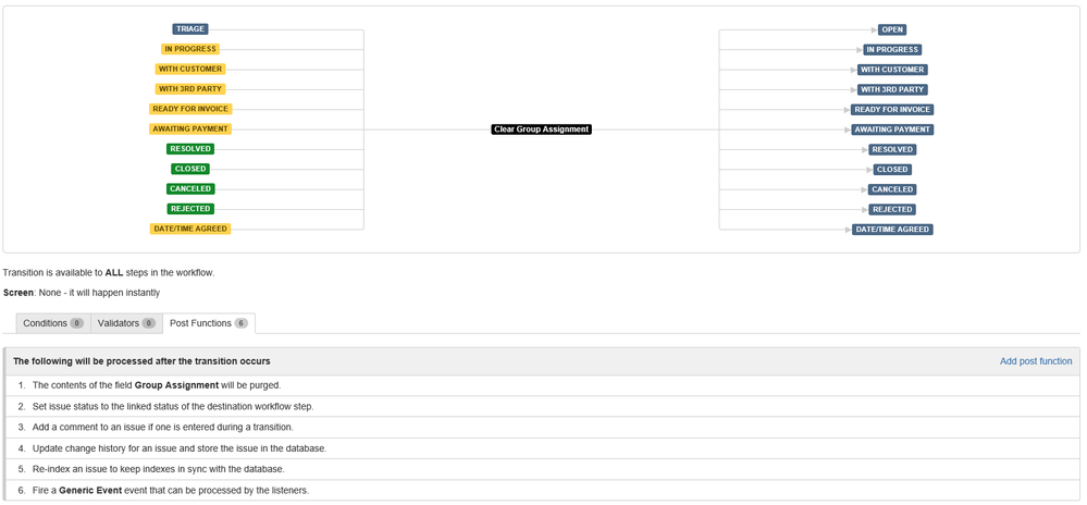

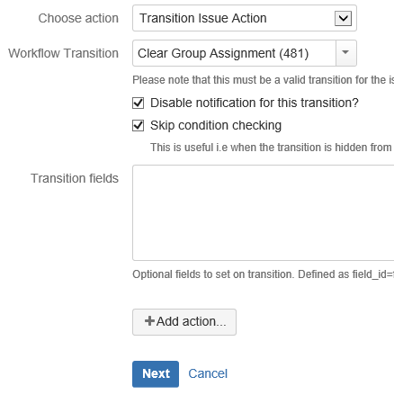

thats similar to what we have already tried. we ran automation to pick up the event listener to set off a looped transition to clear the content of the field.
it worked for a while, but has now stopped working. i have re-created the automation and the transition, but it still isnt working.
screenshots to follow...

Yes I see, pretty close.
I dont have a sandbox at the moment so I can't test my theoretical answer for you.
It'd be kind of neat though having an assign ticket trasition, which also wipes out the group assignment.
