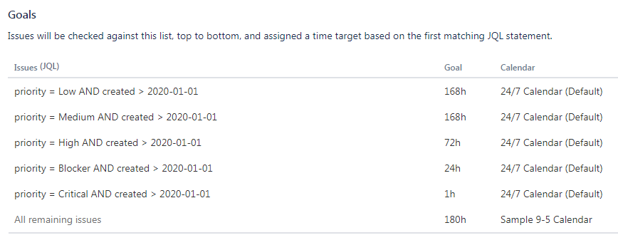

You can change the sla goal filter to only include issue after the date you turn on the sla. Such as “createddate > 2020-01-01 and...

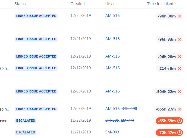

I think I must be doing something wrong; editing the SLA to include the date does not update the tickets that have already been marked as having breached. Here's what my SLA looks like; note that I've tried both created and createdDate with the same result:
sla.pngAnd here's what my queue looks like. Based on created > 2020-01-01, none of these issues should be marked as breached, but all of them are. I realize that in the queue, I could use the create date as part of the filter to hide any issues that were created after the SLA was added, but that won't actually remove the breached flag, and it will still affect any reporting we do.

trying to consume this but don't have all the info to do so effectively, i.e. priorities of issues and the sla rules itself. Can you share that info?
I guess what you were not expecting are the last two issues (-65h and -72h) to be shown or are are some of the other issues not expected?

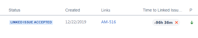

Most of those issues should not have been marked as breached. For example:
sla.pngThis issue has a priority of Low and was created 12/22/2019. Based on the SLA goal for Low priority, it should breach at 168 hours. It did; when I mouse over the SLA column, it shows the actual time spent as 264 hours, which does account for the -96 hours of breach time. But it was created before the date listed in the SLA goal, so I wouldn't expect it to display, based on what you said in your answer (include the date in the SLA goal to only include issues created after the SLA was turned on.)
ETA: never mind. They're all being caught by the "all remaining issues" goal. I'd need to write another goal to catch those; something along the lines of "if created before specific date, don't have a goal."

Curious if you were ever able to get this to work. For me I can write the JQL that shows exactly what I am after (breach on SLA after X issue created date) however when I add that to an SLA as a new custom goal, the All Remaining Issues still seems to override it.
