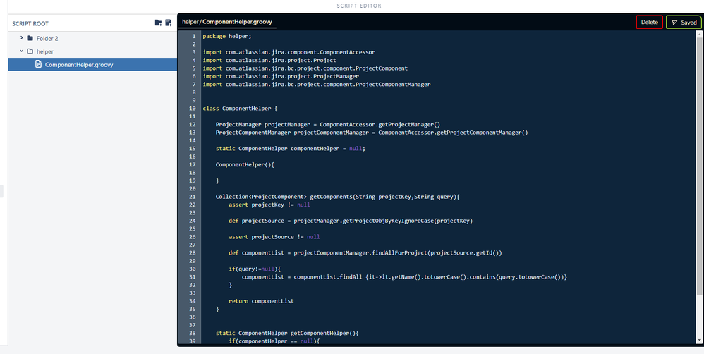

Then you can create a folder to organize your code, in my example I created a helper folder.
Then you can add here the code that does all the heavy work and you would like to share it with your Listener and Rest endpoint, in my case my code will return all components from a project key, and it can filter by what the user is typing ( I had this from a previous question),
Here you can find my code:
 https://gist.github.com/ItaloQualisoni/1c9791eb08f4e112a6a8b09015ce208e

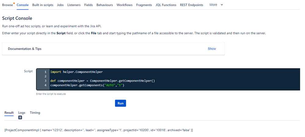

Then you can use this code importing your new class in your Rest endpoint , workflow condition/validator/post-function or Listener, simple example here how to import and run in Console:
And you can then reuse in your Listener in the same way, below is how I did in my example:
