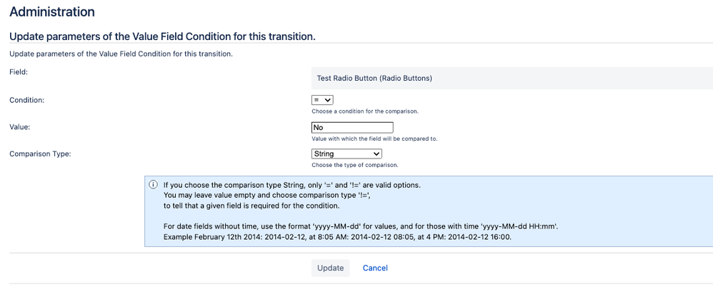

Assuming you have a custom radio field called "Test Radio Button", with possible values "Yes" and "No".
If you want to hide the transition when "No" is selected, add a "Value Field" condition to the transition and configure it like in the screenshot below.
I hope this works.
