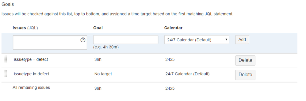

This is possible. When you are setting up your SLA goals, you would use JQL to set a specific target for the one issue type that does have a target, and set No Target for the others.
For instance, if the one issue type I wanted the SLA for was defect:

You may have to set the opposite of that to No Target.
You have:
issuetype = Fault AND priority = Critical
One way to do the opposite of that is this, add this below set goal to No Target.
not(issuetype = Fault AND priority = Critical)
