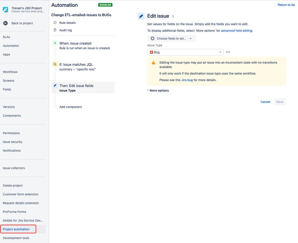

With the information provided, here's how I'd solve it:
1. Turn on email ingest for the JSD project
2. Make sure you have the issue type of Bug in your issue type scheme for this project
3. Run an advanced issue search with the following JQL:
summary ~ "your text from the email subject"
...and make sure if finds the correct issues.  Alter the jql accordingly until you get it dialed in.
4. As a Project Administrator, Go to Project Settings > Project Automation
5. Create New Rule
6. Select the Trigger: "Issue Created" and Save.
7. Click New Condition and select JQL Condition
8. Copy your JQL from step 3 and paste it into the JQL Rule Query field and click Validate (make sure it validates). Click Save.
9. Click New Action > Edit Issue and type "Issue Type" and then check the box to select the Issue Type field.
10. Click the Issue Type dropdown field and select Bug, then Save.
11. Name your rule intelligently, then publish it.
Testing:
12.  Send a test email to the address configured in Project Settings > Email Requests with the appropriate words in the subject line.
The email will have created an issue and if set up correctly, the Automation Rule will have changed the Issue Type to Bug for you.

Hi Trevan - So I followed the steps you listed above and I'm getting the following error message when I try to process an email "You can't edit the request type because the issue type it's based on was removed. To restore the request type, add back its associated issue type in this project's issue type scheme"  I'm sure i'm doing something silly.  Hope you can help.
Trevan Householder_Isos-Tech-Consulting_
August 12, 2020
@larias Make sure you have the correct customer request type associated with the correct issue type.  Then ensure that you have that customer request type configured to be used for email requests in your project email settings.
