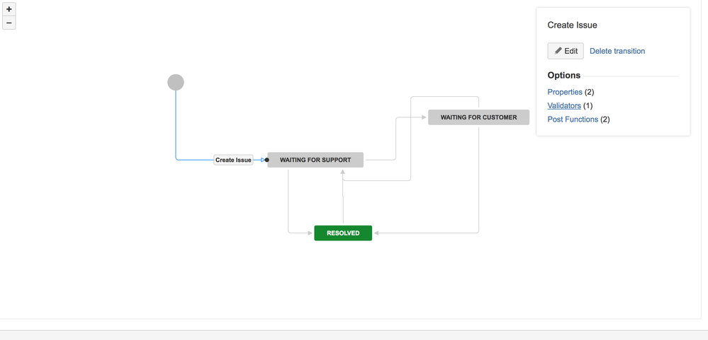

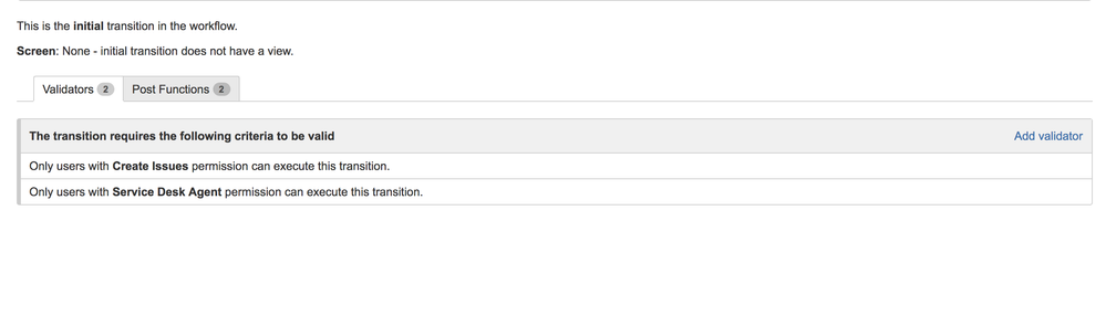

Rather than taking away the ability to create permissions through the permission scheme, you will need to restrict users at the workflow level. Navigate into the project settings and on the create transition for each workflow, place a validator such that only users with the "Service Desk Admin" permission can created.

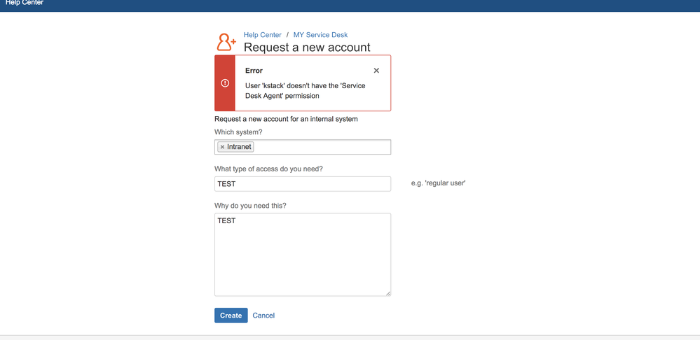

This will still make users able to fill out a form, but block them from actually raising the request. I would place something on the portal itself warning users not to fill out tickets as they won't be able to raise them.

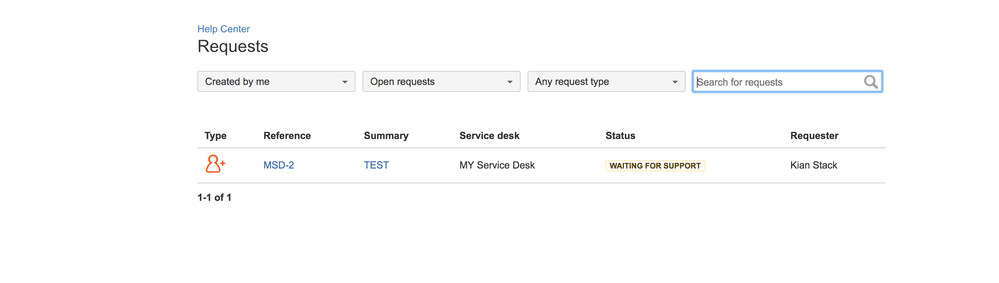

This allows users to browse and edit previously raised tickets without being able to create new ones.
