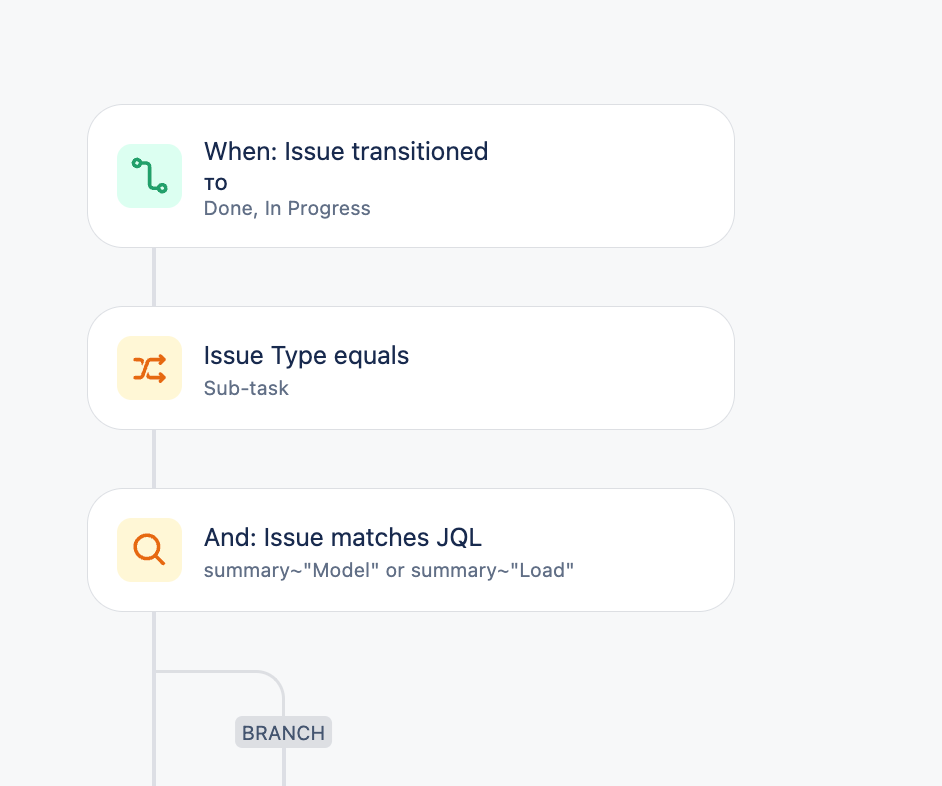

You might want to try a rule like this
I changed the trigger to specifying just the destination statuses that you're looking for; Done (or Completed) for the Model subtasks and "In Progress" for the Load subtask. I did this to account for the scenario where maybe Load got changed to In Progress before the last of the Model subtasks was changed to Complete.
Then there is a condition to confirm that the transition occurred on a subtask type issue.
Then there is a another condition to check the Summary of the triggering subtask, to make sure it was a Load or Model subtask.

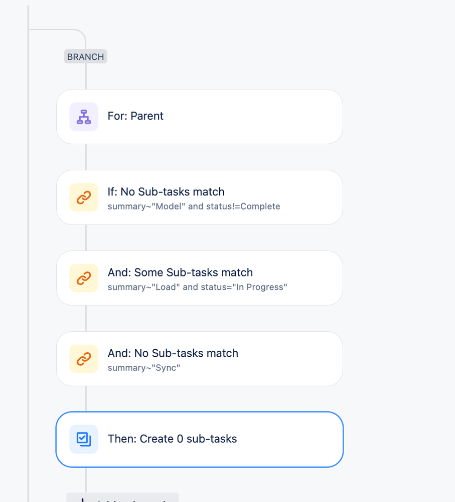

Then start a branch to change focus to the Parent of the triggering subtask.
The first condition checks that there are no "Model" subtasks that are not Complete.
The second condition ensures that the Load subtask in In Progress.
The third condition ensures that the Sync subtasks were not already created (in case the statuses on the Load or Model subtasks recycled and the Sync subtasks were created previously).
If all three conditions are met, then create the Sync subtasks.
