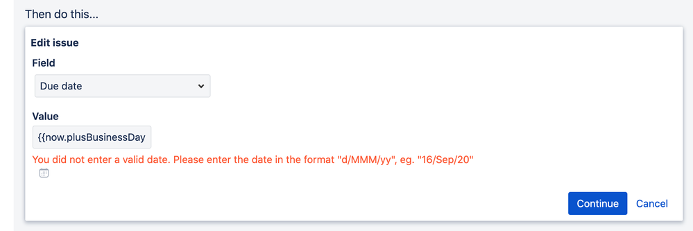

I wanted to put {{now.plusDays(2)}} in the Due date field so that when new issue is created, the due date is automatically updated.
However, I get this warning:
Screen Shot 2020-09-16 at 10.35.07 AM.pngCan you please help us to solve this issue? Thanks!

Hello @Miyoung Mary Kim
Thank you for reaching out.
By the screenshot you provided, I believe you are using the default Service desk automation, however, the smart value you are trying to add {{now.plusBusinessDays()}} is a feature of Jira automation, so it will not work there.
You can check below the main differences between both automation features:
Automation for Jira vs Service Desk automation

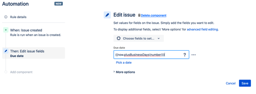

That being said, please follow the steps below to properly configure the smart value as you need:
  1. Navigate to your project > Project settings > Click on Project Automation (Not automation)
  2. Create the rule as displayed in the screenshot below, selecting the trigger and conditions you need and adding the correct number of days between brackets in the smart value:
Let us know if you have any questions.

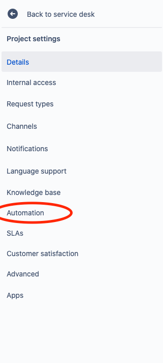

Hi @Petter Gonçalves Thanks for your help. I'm trying to follow your steps but I'm stuck with finding Project Automation. I only see Automation in the Service Desk Setting.
After I clicked the Automation in the screenshot, it is the same place that I can't add the smart value.
Please help me to find the Project Automation. Thanks.
Petter Gonçalves
October 9, 2020
I believe you are using a Next-gen project. Is that correct?
If that's the case, I believe the project Automation must be displayed under the Apps menu:
Can you confirm that?
Miyoung Mary Kim
October 9, 2020
Yes, I'm using Next-Gen Service Desk. Yes, I found the project automation under Apps! will try it now. Thanks!
