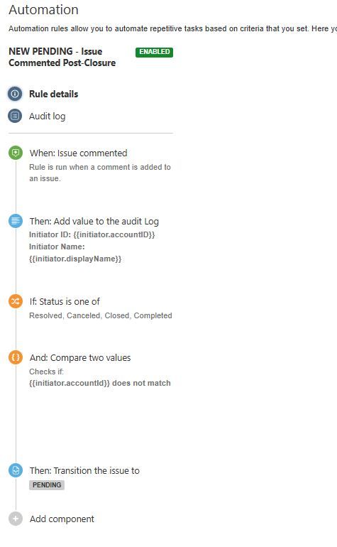

Currently I have an automation in place where if anyone other than the assignee comments on a Resolved/Cancelled case, it will throw the case out of that status and into "Pending". I monitor these instances since email alerts do not go out once a case is closed out. It works great!

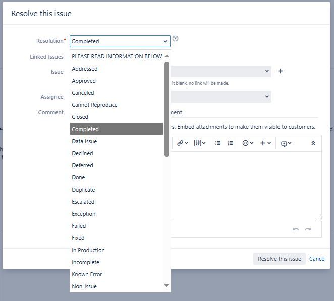

When resolving a case, we have instructed our group to only choose certain Resolution Types in the drop down so that we can use this data in monthly reporting. This allows us to get a better understanding on the type of resolutions and for certain ones, we can easily dig deeper to determine areas of opportunity.
We rolled this process out last year; however, many times people will fail to select the proper resolution type, resulting is those who monitor these to reach out to these individuals and ask that they properly update.
I am looking to set a new automation to where if someone selects any resolution type other than the 5 we have instructed they choose, then once closed/cancelled then the case would then be triggered back into "Pending". What is the best way to accomplish this?
For reference - I've attached an image of the current automation in place for when anyone other than the assignee comments on a closed/completed issue.

When someone goes in to disposition a case (say they click on Resolve), on the next pop-up there's the Resolution field that defaults to "Completed". There are 45 options and of these 45, we only choose 5. Due to using a template, we are unable to edit these 45 as i've already submitted a ticket to do so. My hope is that we could establish an automation that basically says if any Resolution outside of those 5 are selected, then once case is resolved it will then trigger it into a pending status which then would generate on my Pending Dashboard list.

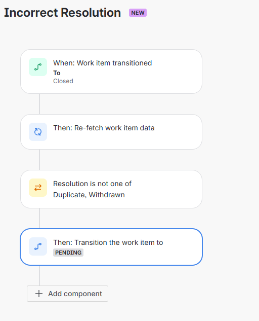

Hi @Mike Thomas,
when you are not able to update your workflow or create a copy of the workflow that would be used only in your project, I understand why you want to create a automation rule.
You can create something like this (just change the Status Closed if you use different and add Resolutions you would like your users select):
