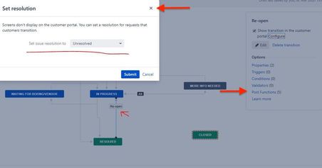

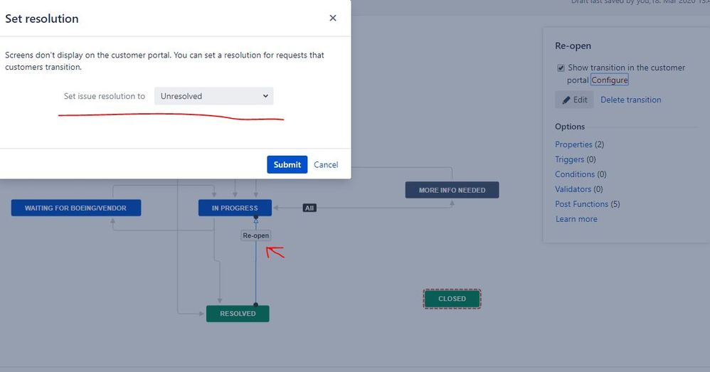

Ok I got the thing to work. How ever now the transition is not changing the resolution to "Unresolved" as configured. See below.
Skuli,

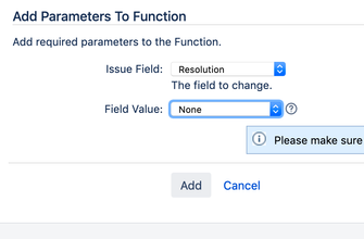

This is because what you are configuring only applies to when a customer uses the button on the portal to reopen the ticket. Instead, click on Post Functions .
Once there, click Add post function.
At the very bottom you should see the Update Issue Field post function. Add that.
Then pick the field Resolution, and the value None.
Flawless victory!!!!
