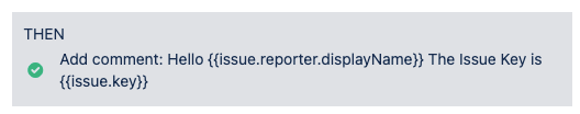

I'm not successful though, looking at the automation log I see a success with the following:Screenshot 2022-11-23 at 15.10.39.png
Looking at my ticket I have the below comment:

It looks like you are on the server version and not on the cloud version. This is my mistake. I have taken a look at the server documentation and the values should be:
{{reporter.displayName}}
{{issue.key}} should work on server as well though.
I am not very familiar with the server version but perhaps it has to do with the version you are currently on. What is your server version?
Here you can find the values for server: Server Smart Values
Make sure to read the related documents as well to find the keys you need for other data points
