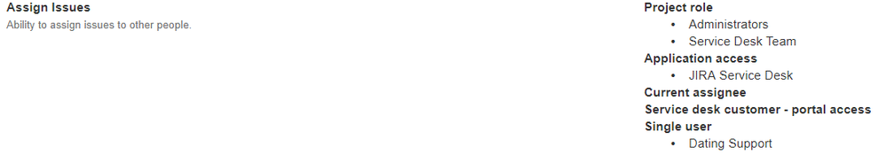

My permissions are the following:

I see u have "Service Desk Team" project role as being able to Assign Issues which is good. Now check to ensure that the users are in this role. If they are then the user should be able to assign an issue to another agent.

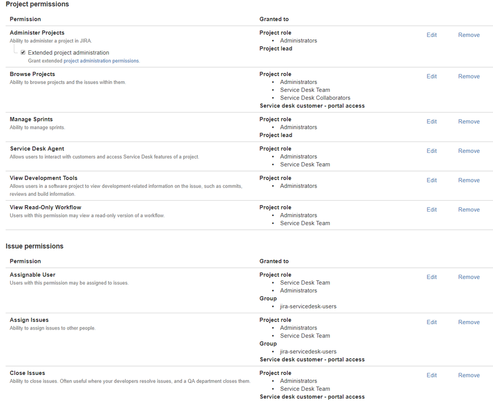

I just raised the permissions, without any impact:
