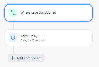

Hi @Ashley Honeycutt
I'm not too familiar with the legacy automation, there is a delay option in automation rules so might be worth recreating approval notifications as a new rule if you're not seeing the delay option.
Some other options that might help
  • Setting the trigger to when approvers are added
  • Adding a notification at the end of your rule that adds the approvers and keeping the legacy rule as is.
Hopefully some of these suggestions help!
