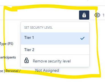

Thank you for the response.  Yes we did want any tier 2 issues to not be visible to tier 1 group members.  The reason was some sensitive issues are created by default as tier 2.  they can see the tier 1 level but not tier 2.
Tier 1 group view:
Tier 2 group view:
I checked my "set issue security permission" and all tier 1 and tier 2 roles have access to set it.
I did a workaround of making a custom field with tier 1 and tier 2 options and used automation (which has access to both security levels) to change the security level when that field is changed.
