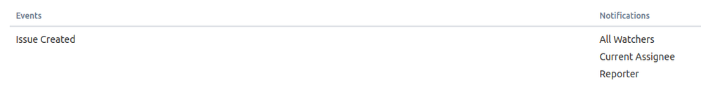

We have an agent assigned to each request type that is created. Given the notification scheme, as the assignee they should get an email

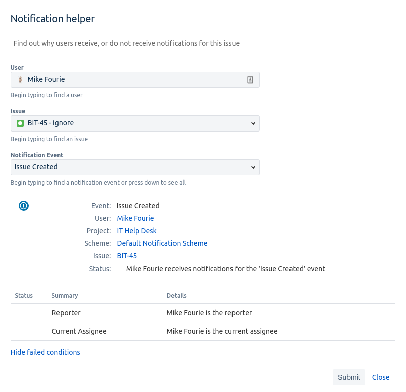

Using the notification helper it seems i should get the email

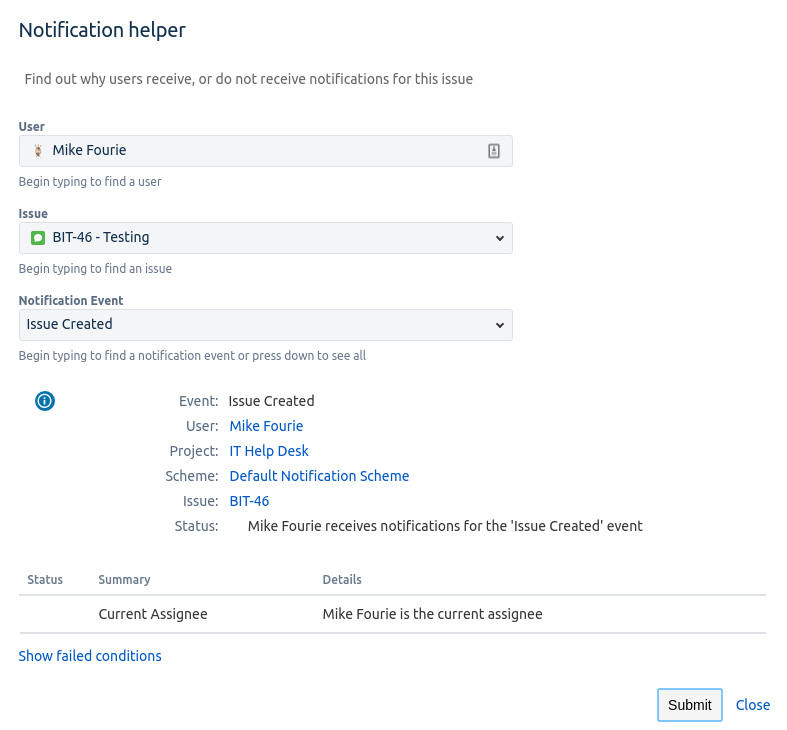

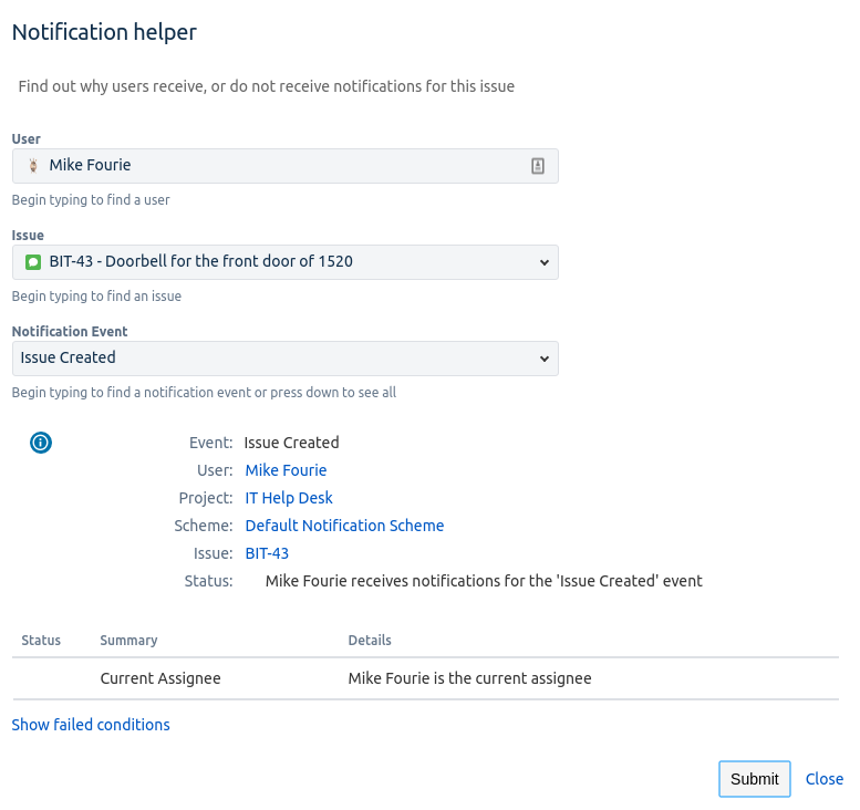

Ok I removed the group which had all full timers as customers. Created a ticket myself and had another agent create a ticket. in both cases i'm the default assignee. In both cases I still get no email. :-(

  • users do not get notified of their own actions unless the user specifically requests this to occur (not a normal thing). I mention this as the image above seems to fall into this category.
