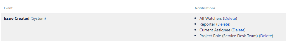

Have you taken a look at your notification scheme?
You can access that either through the notification schemes and see which one is linked to your project OR go to project settings and see what is set on "notifications"
There you should have an event for "Issue Created" and a list of roles/groups/users that are notified.
For example:
