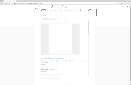

After searching on the customer portal, when home or back to results is clicked Jira seems to hang
CRC Technical
July 10, 2019
I have checked the logs using the tools in Jira but there are no suggestions as to why this is happening. The customer account has to log out and login again to get Jira working again.
If I look at the logs in Edge when trying to perform these actions I get some error messages whilst the loading "do-nut" continues to spin.
