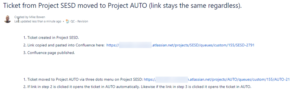

I was able to replicate your request and this is what I found:
Ticket moved - confluence link redirects automatically  leaving original URL.png
-Mike

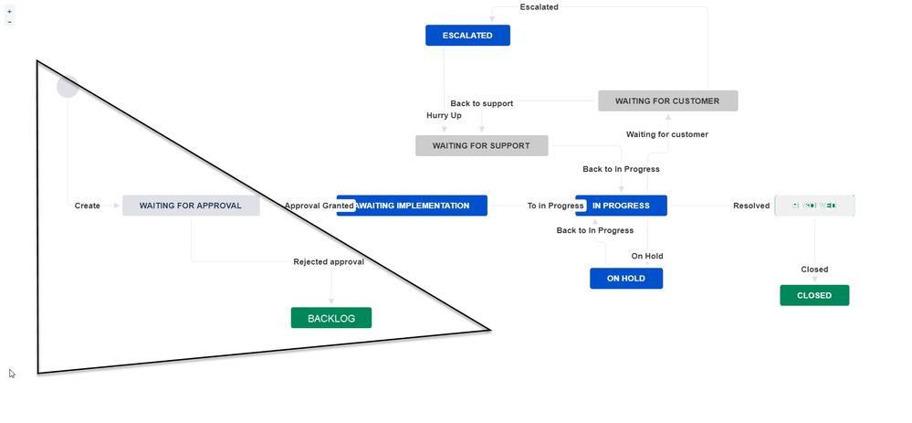

To give you an idea what I run, and I'll show you how we have a very similar setup to what you are doing, but in one project
In this Jira Service Desk project we set up customers (external or internal users) into organisations, and link the organisations to queues, which are owned by the agents. The customers log requests via the Customer Portal. Requests are broken into Issue Types. (we have multiple issue type in the project).
The default issue type doesn't have approval linked to it. Customers simply log requests and they arrive in the All Open Requests queue where the agents pick them up and work on them. Here is the workflow.
Another issue type is Professional Services, which requires approval before they can be worked on by our agents. Approvers can be customers and internal managers (e.g. myself) or a group of people. At the ticket creation step I can force the reporter to select the approvers. If a request is rejected by approver(s), it goes into the Backlog. If a request is accepted (must be accepted by customer and internal manager) it goes into Awaiting implementation (or the All Open Requests Queue) and gets picked up by agents who will deal with the request as per normal.
professional-services workflow.pngThe above workflow would be very similar to what you are doing over two projects, but can be achieved in one project and remember one project can have multiple workflows linked to it depending on the Issue Type being used.
Agents can communicate to customers (visible to all) or they can communicate internally (not visible by customer). Agents can also link the request to other projects (e.g. DEV team, or DevOps team), but customers will never have visibility on this, nor can they see comments or anything made my Dev or DevOps. They only see their requests and or the comments from the agents made to them.
Basically everything you said can be achieved in one project. Food for thought!
