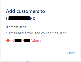

I'm trying to add an existing internal Jira user to a Service Management Organization but I get the following pop-up and the user is not added.
The other people in this organization are also internal jira users and one is also an admin.

@Tamara Schacham -
Have you check to see if the specific user account has a valid email address?

Tamara Schacham
August 29, 2023
Thanks, Joseph!
The email is valid. But, when I checked, I noticed that there are two accounts with the same email, and one of them is inactive.  That's the one getting picked up when I try to add the customer.
I'll see if I can work around this.
Tamara Schacham
August 29, 2023
I tried adding the customer with his username (which was unique) instead of his email ID, and it worked.
Joseph Chung Yin
August 29, 2023
@Tamara Schacham -
The inactive account should be either removed from your env or change the email address, so the active account has a unique email address.
Best, Joseph
