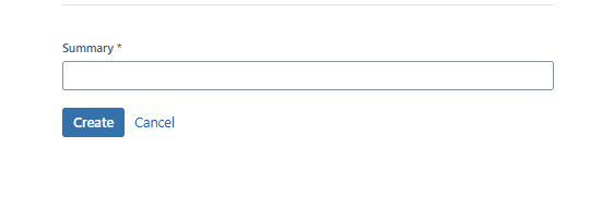

I have this issue type and when I go to Raise a Request I have this screen
How can I add more fields like Description, Request Participants, etc
Thank you!
Marc -Devoteam-
January 27, 2026
Hi @Monica
@Chris Rogers is right.
I have added the DC documentation link for you; setting-up-request-types
Chris Rogers
January 27, 2026
Hi @Monica
Adding fields to a request type is done under the Project/Space settings -> Request Types.
It's a bit different on data center than cloud but the following documentation should help you if you have administrator permissions:
https://confluence.atlassian.com/servicemanagementserver/setting-up-request-types-939926357.html

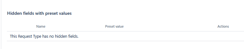

Monica
January 27, 2026
Thank you so much for this @Chris Rogers how do I go about adding fields in this section?
Chris Rogers
January 27, 2026
Hi @Monica
You'll need to add the fields you'd like to the Create screen for whichever issue type is mapped to this request type.
For example, if this were a Software Request (request type) mapped to Service Request (issue/work item type), you'd need to ensure the fields you want are on the Create screen configured for Service Request.
The following documentation should help:
Adding custom fields
Associating a screen with an issue operation
