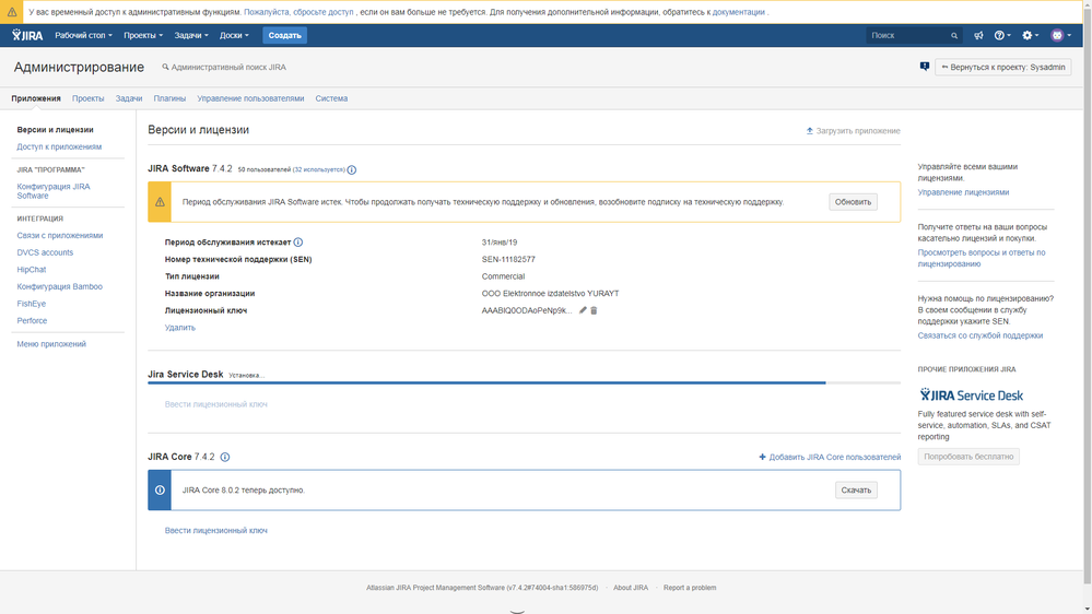

Добрый день при попытке установки, зависает и сбрасывает процесс установкиСкриншот 2019-03-19 18.01.31.png

Angélica Luz
March 19, 2019
Hi Alexandr,
Thanks for reaching out to Atlassian Community.
I see that you have two licenses, one for Jira Software and other for Jira Service Desk.
This SEN number that shows on the screenshot is for Jira Software which has expired on February 1st.
There is another SEN number that is specific for Jira Service Desk, it ends with SEN-XXXXX729. Please check your subscriptions and copy/paste the license key for you to be able to install Jira Service Desk.
If you face any issue, please let us know.
Regards,
Angélica

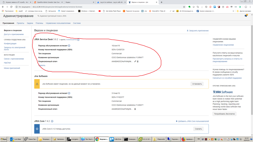

Сисадмин Юрайт
April 10, 2019
hi, even the demo is not installed, despite the fact that the empty jira service desk is installed, but as soon as I roll the backup, the service desk application disappears.
Angélica Luz
April 12, 2019
Hi, just to make sure that we are on the same page, when you say roll the backup it means an import?
Are you installing Service Desk before creating a new backup?
Сисадмин Юрайт
April 15, 2019
1. my version 7.4.2 I install service desk on it and get a positive result. 2. I have a server with tasks on which I cannot establish service desk, I do imort (backup) and I try to restore on the server on which already established service desk after restoration service desk shows to establish and at attempt to establish gives an error
