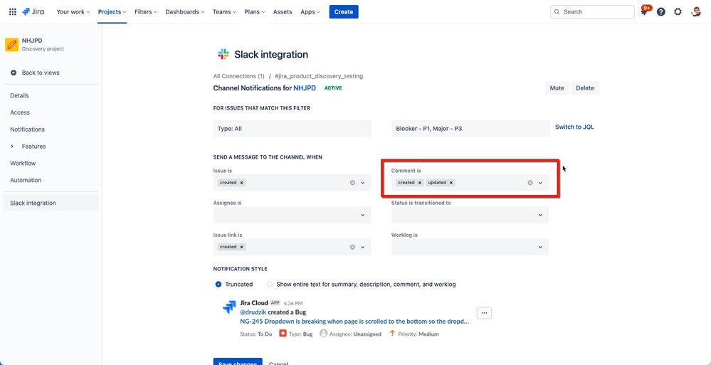

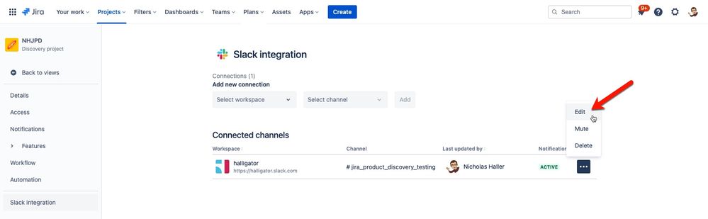

Under your JPD Project's settings >> Slack integration tab, you should be able to control what messages are sent to Slack such as comments:

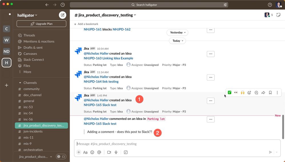

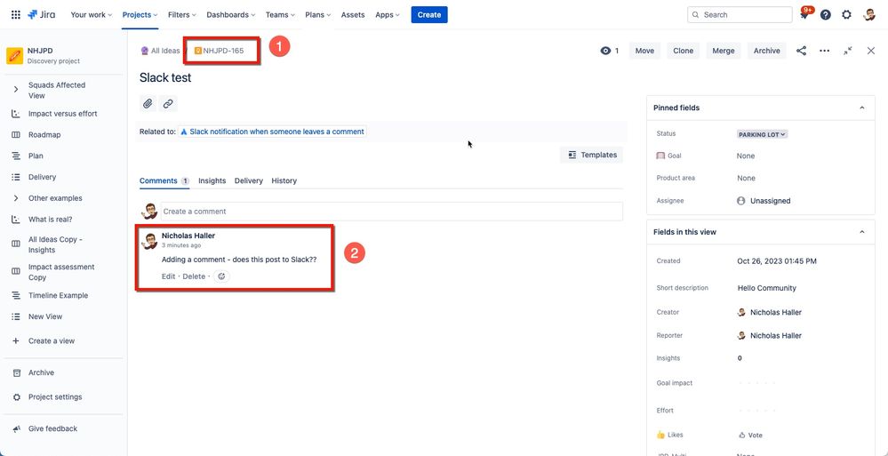

I tested and it worked as expected, so maybe check those settings to see if they include adding a comment:
