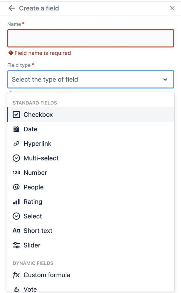

In JDP you can't choose "paragraph" type for fields, that's why i choose the "short text" type, maybe that's why there are problems? Turns out I can't choose standard Jira types on JDP?Google Chrome_2022-12-07 18-39-16@2x.jpeg

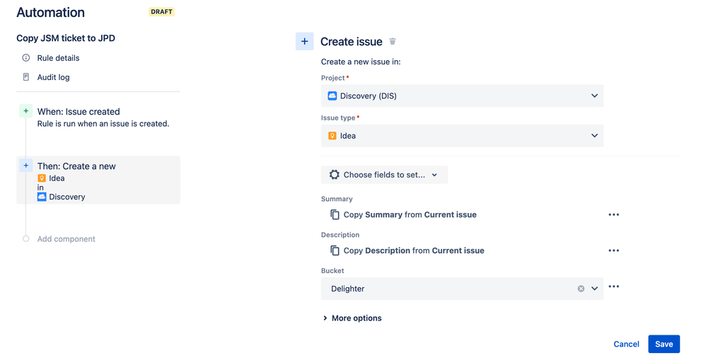

However, it is possible to set the value of custom fields directly in the rule and this works well. This rule created an idea in my Jira Product Discovery project which had the value "delighter" for the field named bucket. You could then create conditions, and have different values set according to the request type for example.
If this one isn't working, it might be what Chris suggested, as in my case I have multiple bucket fields, I needed to select the correct one.

I'd like to add paragraph fields to JPD ideas as well. We have another project that acts as a Project Intake Form (JSM, TM, Cloud) and we need to be able to shoot the contents of those paragraphs into paragraph fields in JPD. We use Elements Copy and Sync to sync fields so that they stay the same.
I've tried to do this and it seems like the "Short text" custom field type is not long enough to manage this.
Any suggestions on how to do this?
