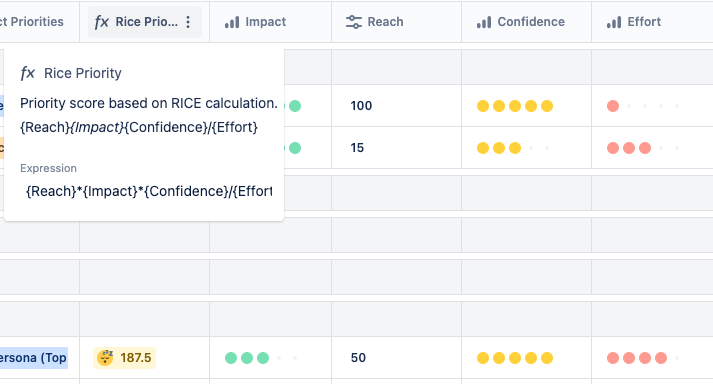

Hi Jack,
Do you mean you need to calculate the RICE priority score in JPD based on the existing elements you've had? You could just edit the expression of that field. Something like below:
