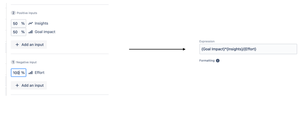

Hi @Radosław Bielak
For now, it is not possible to have a weighted score just for a certain view. We are exploring how it could be done, but we stumble into a few edge cases that wouldn't be ideal so we will continue to work on it.
To take back your use case, there are two workarounds that you could implement:
1. Preferred solution: Use a "Write your own" instead of of "Weighted score" Formula.
The problem with the weighted score in your case is that it considers all ideas and normalizes the score to give a scale from 100 to 0 regardless of which "numbers" are used as input. So in your case, the score is "tied" to all ideas in the project, which probably doesn't make sense if your teams are working on two very different product areas.
When using your own formula, the score appearing there would be an exact reflection of the fields used, without taking into account other ideas in the project. Each idea would have its own score, so you get and objective number in the formula column that can be used in different views.
2. Least preferred option: keep the weighted score and use different fields.
You could create fields, Effort A, Effort B, Goal A and Goal B, and you fill only the correct fields for each idea, then you create two formula fields reporting on fields A and another one reporting on fields B, and you can implement these two fields in two different views.
Besides the fact that having multiple fields serving the same purpose seem counterproductive, I think this solution is unmanageable with more than three different groups.
Regarding archived ideas, we should indeed not include them in formulas, so we will add this to our backlog and prioritize it on the roadmap. Thanks for your feedback !

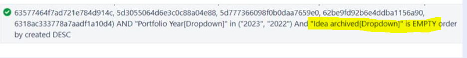

Charu Takkar
February 12, 2023
Hello @Radosław Bielak
 While creating report  I added an additional  filter to remove archived ideas using the advanced JQL-Capture.PNG
Not sure this is exactly what you are looking for.
