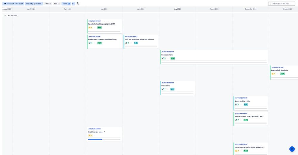

Timeline view keeps pushing all of my tickets to be on seperate lines.
I'm trying to have a lot of my tickets side by side (horizontally) so I can better see in one view what's happening.
However, sometimes when I add a new ticket, it throws off the whole page and every ticket then has it's own individual row. This results in all of the tickets being shifted down the page and it's really difficult to track what's happening.

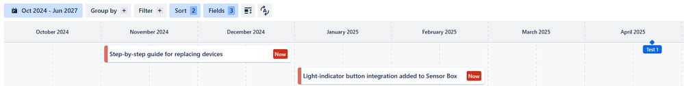

Damian Trutkowski
February 6, 2025
Hello,
I’m experiencing the same issue. No matter what I try, I can’t get ideas to be displayed side by side. Instead, each idea gets its own separate row, even though there’s a lot of empty space. This makes the timeline less effective for presenting the roadmap. Has anyone found a way to fix this?

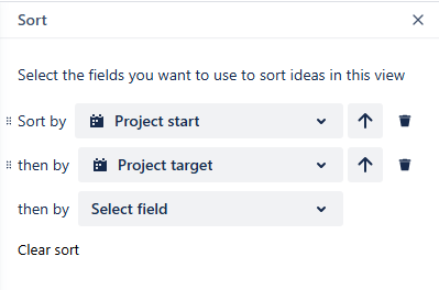

Tanguy Crusson
February 6, 2025
Hi, that's because you are sorting by these fields. Just delete these 2 sort options and you can put ideas in the same row
Like Damian Trutkowski likes this
Damian Trutkowski
February 6, 2025
Hi, thanks for the quick response.
You’re right .... I read about this in another post on the forum, but when I tried dragging ideas vertically it didn’t work. Now I see why - because I had sorting enabled.
