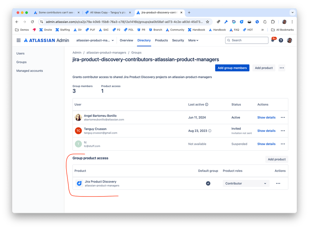

Tanguy Crusson
October 9, 2024
HI @Solenne CLEMENT , that's weird indeed. Can you please check that the contributor group is configured with the contributor product access for JPD?
