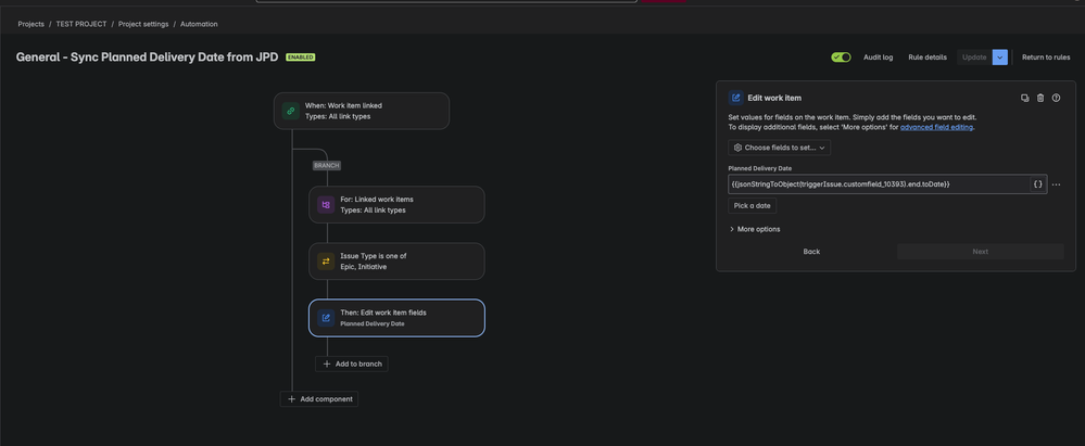

  • Automation Rule triggers when a JPD Idea is linked to an Epic.
  • The rule is configured to edit the linkedIssue (the Epic).

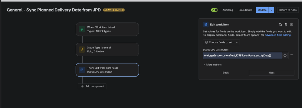

  • I'm pulling the value from a JPD field (customfield_XXXXX) whose value, according to the API, is a JSON string (e.g., "{\\"start\\":\\"...",\\"end\\":\\"..."}").
  • My Smart Value for the date is: {{triggerIssue.customfield_XXXXX.jsonParse.end.jqlDate}} (intended to parse the JSON string and extract the date).
  • I'm writing the value into a Debug Text field on the Epic.
The Problem: The Automation Rule shows SUCCESS in the Audit log, but the Debug Text field on the Epic remains empty. The JPD field is populated, IDs are confirmed, and the rule structure is set to linkedIssue.
Question: Why isn't the Smart Value (with jsonParse) resolving to a value, or why isn't it being written to the field? Any debugging ideas would be greatly appreciated!

Bill Sheboy
May 22, 2025
Hi @Sebastian Pechhold
First, there is no "jsonParse" function in automation rules.  What is the source where you learned that function as it is incorrect?  Some chat / bot perhaps?
There is a jsonStringToObject() function that will help parsing the JPD date format: https://support.atlassian.com/cloud-automation/docs/jira-smart-values-text-fields/#jsonStringToObject--
For example, to get the end date please try this:
{{jsonStringToObject(triggerIssue.customfield_12345).end}}
That value will be text.  When you need it as a Jira date format, add the toDate function:
{{jsonStringToObject(triggerIssue.customfield_12345).end.toDate}}
Next, what is your rule scope: single-project, multiple-project, or global?  The default is single-project scope rules, and they cannot modify work items in other projects.
Finally, your rule shows no branching.  How will it access the JPD date field in the Idea to update the Epic's field?

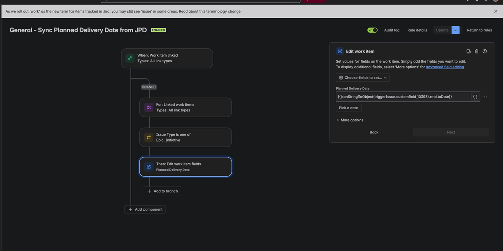

thank you. I changed the setup:
To answer your previous question. Yes, i used Gemini before i got here :)

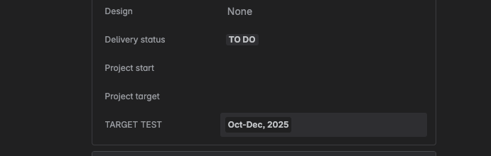

Project Target field (JPD) is not empty. It has a single date or a date from/to (mostly quartery)
Date format month June:
{\"start\":\"2025-06-01\",\"end\":\"2025-06-30\"}
Time frame format Q2 April-June:
{\"start\":\"2025-04-01\",\"end\":\"2025-06-30\"}

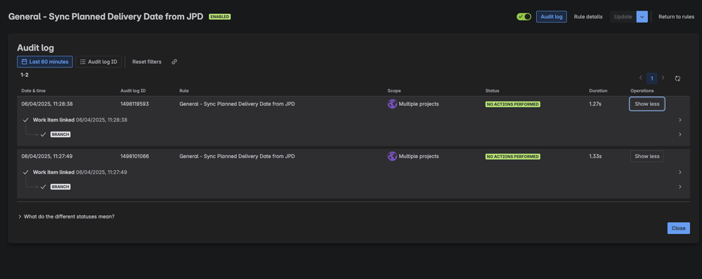

Sebastian Pechhold
June 4, 2025

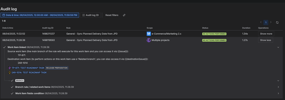

Thanks for your patience. I just linked an Epic to the idea. Nothings happens.
Bill Sheboy
June 4, 2025
At the right side of the log for those entries expand the details with the arrow > icon, and re-post the image.
That will show the issues involved and possibly indicate why this is happening.  For example, if the trigger issue is not an Idea, then you may not be finding the correct ones inside of the branch...leading to the condition to not match.
Triggering a rule on Work Item Linked is tricky, because no matter to which issue the link is added, the "trigger issue" is always based upon the direction of the link type.  Please see this great explanation from @Trudy Claspill on the topic:
https://community.atlassian.com/forums/Jira-questions/How-can-I-get-field-from-linked-issue/qaq-p/2807497#M1050229
Like Trudy Claspill likes this
Sebastian Pechhold
June 5, 2025
It seems that rule is being triggered correctly. But the field is not mapped.
Bill Sheboy
June 6, 2025
I just retested to confirm the behavior based on the link direction noted earlier:
When a "delivery" work item is linked to a JPD Idea, and the rule trigger is Work Item Linked...
  • the trigger issue is the "delivery" work item
  • the destination issue is the Idea
This happens regardless of where the link was added: from the Idea or from the "delivery" one.
As your rule is written, it assumes the trigger is the Idea, which is reversed from what happens.
To update the "delivery" one with the data from the Idea's date field, please try this:
  • trigger: work item linked
  • smart values condition:
    • first value: {{issue.issuetype.name}}
    • condition: does not equal
    • second value: Idea
    • first value: {{destinationIssue.issuetype.name}}
    • condition: equals
  • action: edit work item
    • setting your date from the destination issue's smart value...
{{jsonStringToObject(destinationIssue.customfield_10393).end.toDate}}
In that first Smart Values Condition, I generically tested the trigger one for "not an Idea".  You could change that to use the Field Values Condition to specifically test for your desired issue types (i.e., Epic or Initiative).
However, please note well: if you are using team-managed projects to link to Ideas, the types will vary by project.  So perhaps use the type name to be certain of matches.
Like Sebastian Pechhold likes this

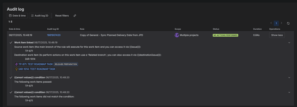

Sebastian Pechhold
June 17, 2025
Hey again!

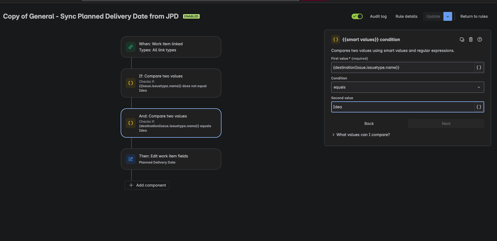

the second smart rule is not working i assume. But the destination is an idea.
It looks like that we are going to solve it soon :D
Bill Sheboy
June 17, 2025
Looking closely, there is a typo: there is only one and not two curly brackets at the start of the second condition in the "first value".  Please add the second one like this:

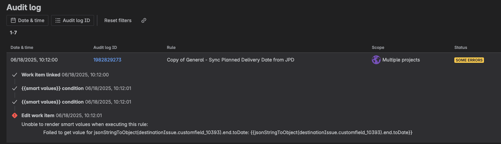

Sebastian Pechhold
June 18, 2025
Getting error with parsing issues. Same with specific date format like 31.12.2025
Bill Sheboy
June 18, 2025
Sorry, I added the toDate conversion which automagically adds a time.  Let's remove that to only use the text from the date range value:
{{jsonStringToObject(destinationIssue.customfield_10393).end}}
That will be in jiraDate format and so should work.

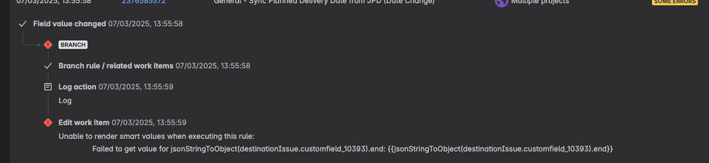

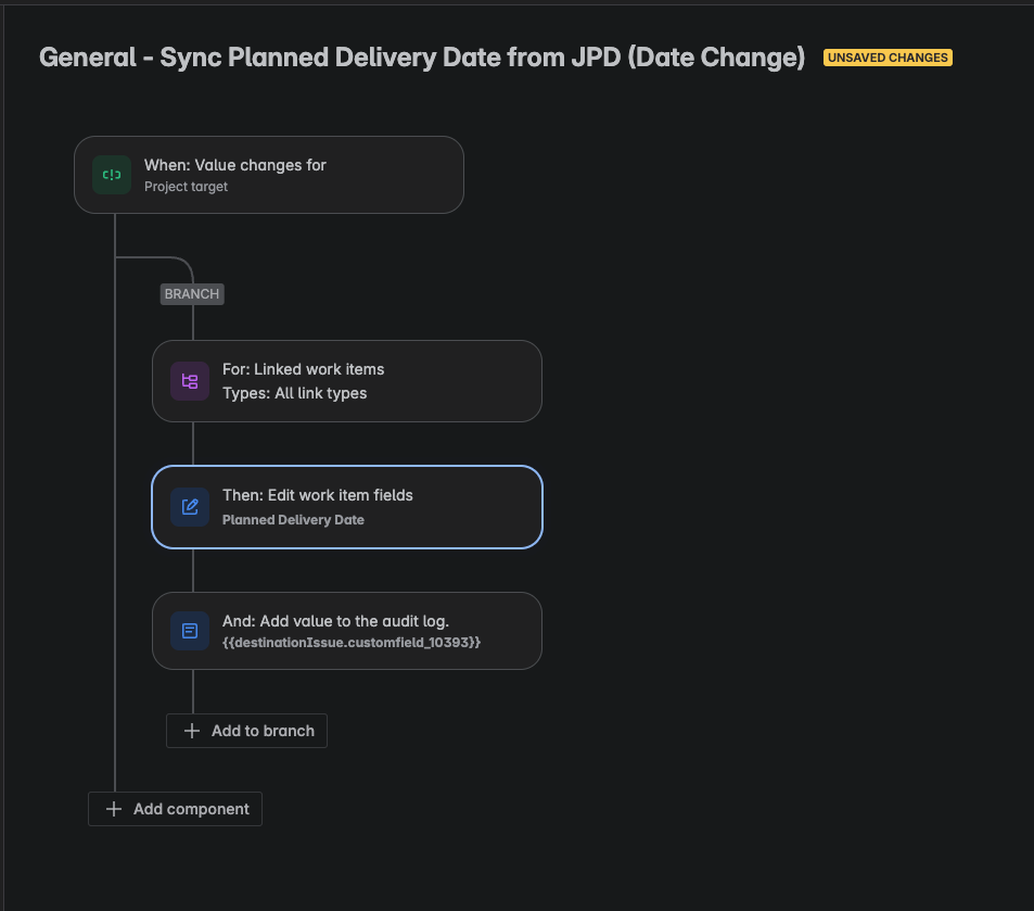

Last question now.
I created another automation, which must sync the Project Target to linked item. Easy peasy - thats what i thought :)
Error:
Failed to get value for jsonStringToObject(destinationIssue.customfield_10393).end: {{jsonStringToObject(destinationIssue.customfield_10393).end}}
i just copied the other automation which is working now and edited it.
Audit log is empty. IDK why! I just want to change the Project Target and sync the new date.
Bill Sheboy
July 3, 2025
The {{destinationIssue}} smart value is only available with the Work Item Linked or Work Item Link Deleted triggers:
https://support.atlassian.com/cloud-automation/docs/jira-automation-triggers/#Issue-linked
If the trigger work item is the JPD one, you may change the expression to use the {{triggerIssue}} smart value:
{{jsonStringToObject(triggerIssue.customfield_10393).end}}
