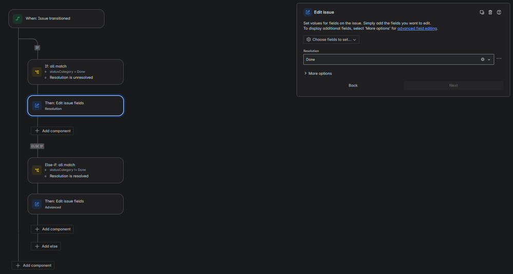

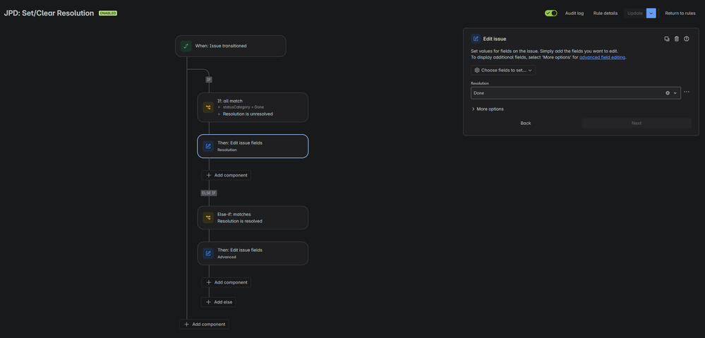

I appreciate consistency across the Atlassian apps. I also prefer to create workflows with a single "Done" categorized status and rely on the Resolution value to indicate if it was completed, canceled, etc. With this not being an option to set within the JPD projects, I've resorted to utilizing an automation rule. I'm not a fan of this method though as the user doesn't have the ability to specify the value themselves.
Here's the automation I have in place (which I just checked and it is working properly):

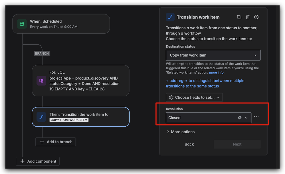

 I just tested one idea with an automation:image.png
projectType = product_discovery AND statusCategory = Done
AND resolution IS EMPTY AND key = IDEA-28

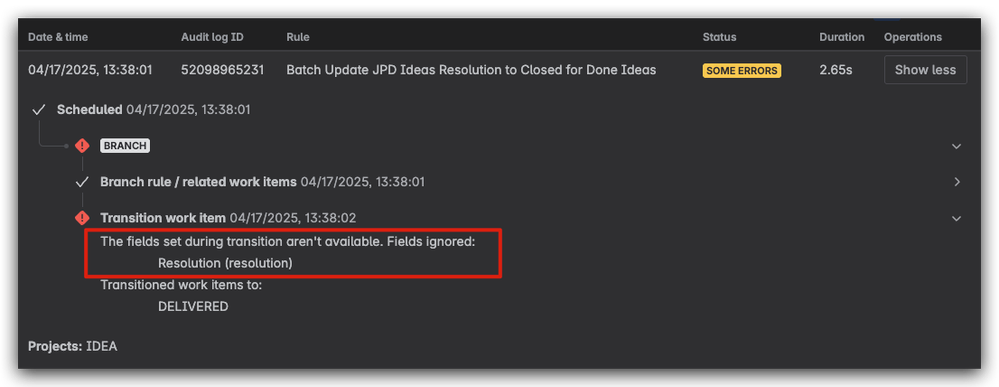

I manually triggered this automation and got an error:
The fields set during transition aren't available. Fields ignored:
Resolution (resolution)
Gary Spross
April 17, 2025
You're getting that error because you're attempting to modify the field within the Transition action, but there isn't a transition screen with that field present (which you can't configure anyway because JPD doesn't support transitional screens). You need to utilize the Edit action to modify the Resolution field. You can add it before or after the Transition action.
Note: Don't forget to remove the setting of the Resolution field from the Transition action so you won't get the error anymore.
Yong Yang
April 17, 2025
It worked perfectly. Thanks.

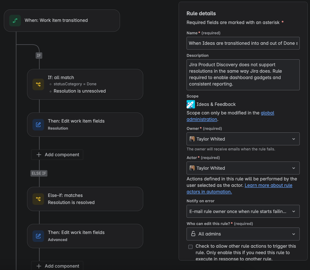

Taylor Whited
June 19, 2025
@Gary Spross wondering if your automation is still working? Trying to set up an identical one and running into this error log on execution for both conditions on the edit work item actions for Resolution. Same automation is able to successfully update other fields like Summary.
Edited work item successfully, however some of the set fields aren't available. Fields ignored:
Gary Spross
June 20, 2025
I just checked and, according to the logs, it's still working as expected.
How are you setting the Resolution field within your automation rule?

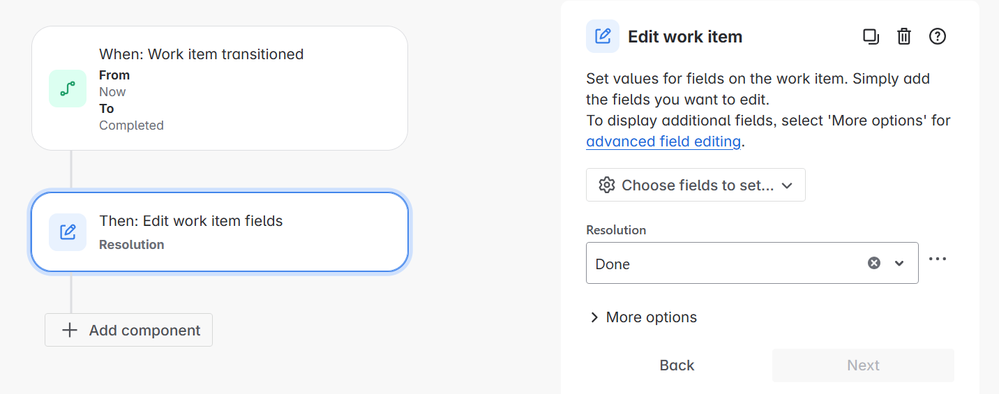

Matt Hadfield
July 31, 2025
Hi @Gary Spross , I am trying to implement a similar automation. I am getting the same error about the resolution field not being available but from what I can see I am using the Edit action the same way as yourself. Any ideas?
