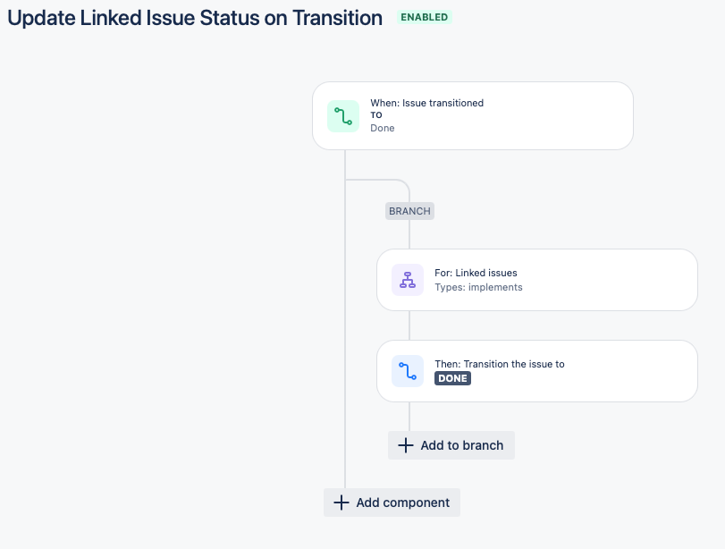

@Glenn A , here's a video of Atlassian walking through the creation of an automation rule that transitions an Idea when a linked (via the "Implements" link type) is transitioned.
The "Some errors" indicating "Destination status could not be resolved" usually indicates that you are trying to transition to a status that is unreachable from the issues current status. Make sure whatever status the issue is in, is able to transition to the status you are trying to set it to.

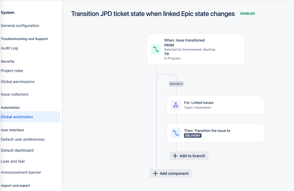

It works... but not the same way as Atlassian's demo video? Also, less efficient as now I need to specify branches (or new rules all together) to handle all the different permutations.

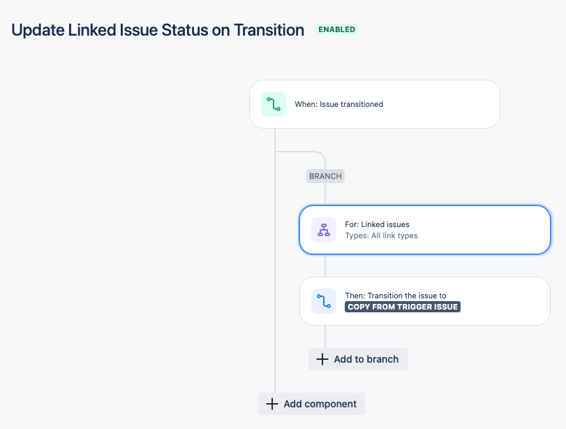

For context, I'm doing this in a personal trial setup (call it a sandbox) before attempting in production at work, so I've created multiple projects across JPD and Jira to sort out the correct settings.
That said, the workflows across both the JPD and Jira projects has 2 states with the same names and conditions (transition in from any): both JPD and Jira project have "In Progress" and "Done" states with "Any" transitions.
I have both the JPD issue and the linked deliver issue in the "In Progress" state. I get the error when I transition the linked delivery issue to Done.
I am the owner of the global automation and it is running as the Jira Automation user.
Here's the screenshot:
Thoughts?
Gary Spross
October 9, 2024
Don't select "Copy From Trigger Issue". Instead, explicitly select the "Done" status.
Try that first and see if it works. If it does, then you will need to include if conditionals to transition to "In Progress" or "Done" based on the status the delivery ticket was transitioned into.

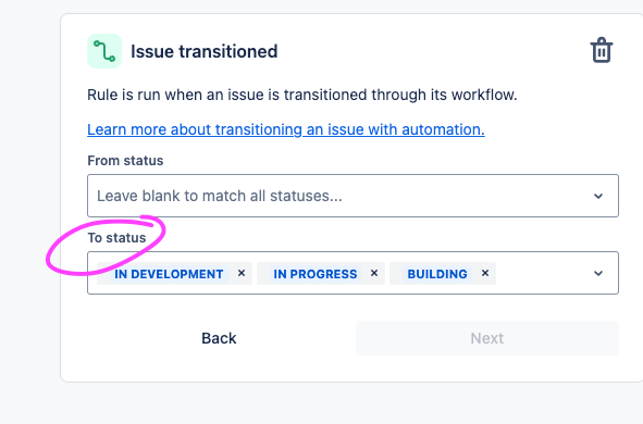

lila
October 9, 2024
You are missing the to status on the trigger
ie
You need to ensure that the to status that you choose does exist on your Jira workflow.
And similarly that your destination status on the Then transition the issue to exist in your JDP.
Also that automation only work for company managed project, if you are on a team managed project it doesnt work.
