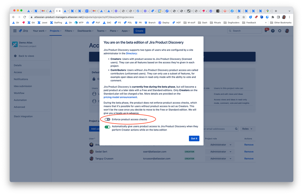

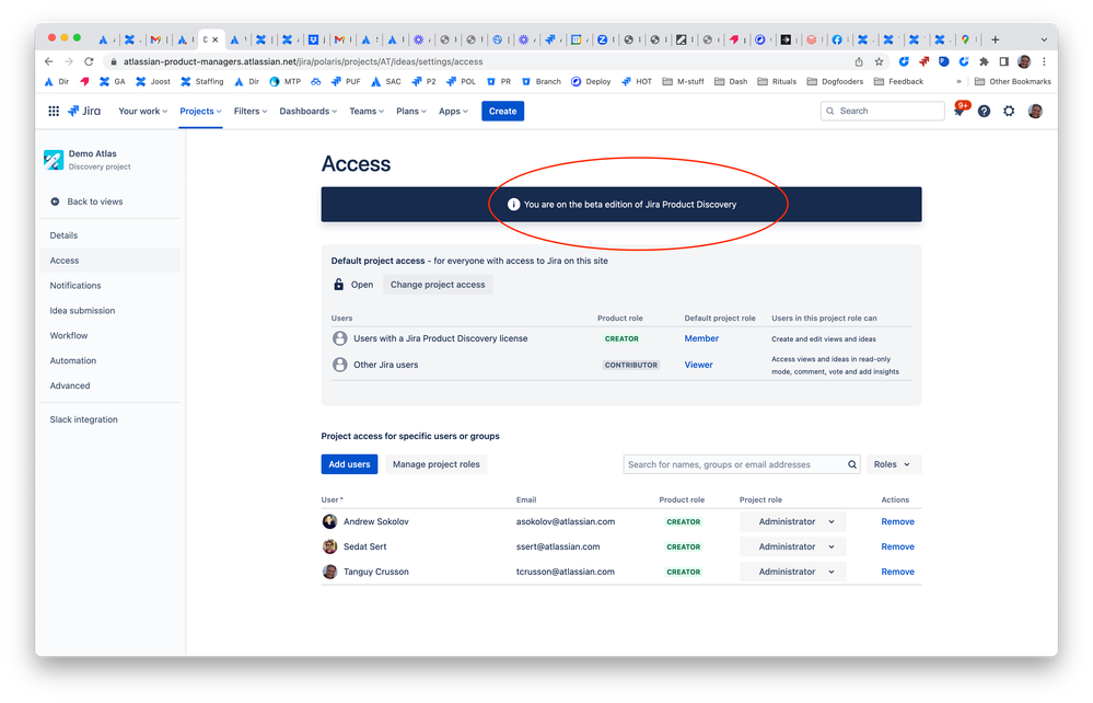

OK, thanks! I think I know what this is then. During the beta we're not enforcing license checks. You have 2 options:
  1. You can make the project access "Limited" and make sure this person has the "Viewer" role (not Member - Member = Creator, we're renaming that)
  2. You can make sure the system enforces license checks:
