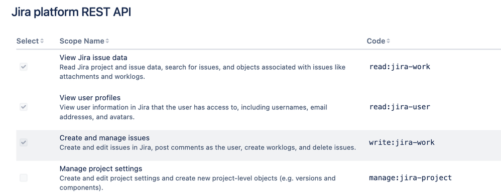

OK are you sure you requested the right scopes? From the instructions:
  1. Once the app is created go to Permissions tab and click Add on Jira platform REST API option. Then click Configure and enable those scopes: View user profiles, View Jira issue data, Create and manage issues.
Anil D
January 22, 2025
Yes same permissions are enabled.
Like Jeny Stoeva likes this
Tanguy Crusson
January 23, 2025
Okay it looks like you've stumbled on a bug after all! We've managed to reproduce this issue in some environments. We're investigating. Thanks for raising this!
