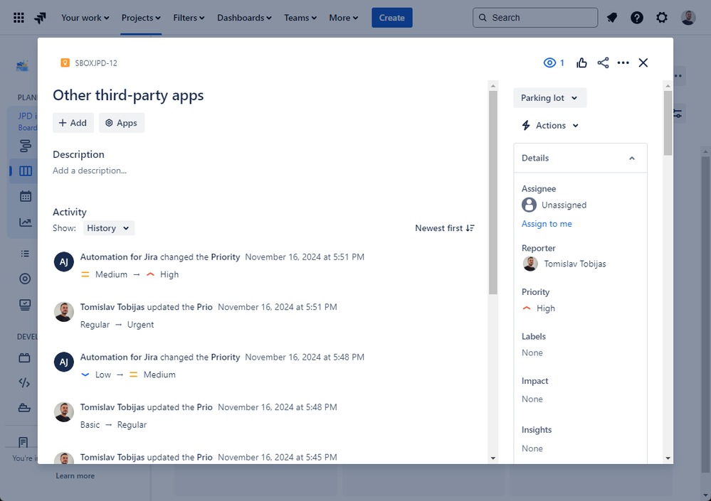

So, you're just displaying ideas on a Kanban board (as part of one company-managed Jira project). Am I correct? You're not actually creating delivery issues within specific Jira (ex. Software) project?
I've tested the automation when updating 'Prio' (select list) field so that it updates the system Priority field. However, as you can see, when I open this idea on the board in my Jira project, I can see Priority field on the right side under 'Details' panel. If everything I've mentioned earlier is the scenario you currently have, can you check if you've got 'Priority' field visible somewhere on the issue when it's opened from the project board?

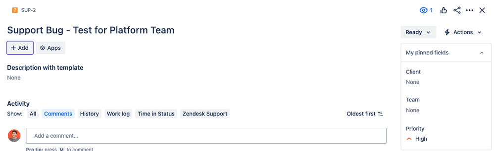

I can confirm, that I can see the 'Priority' field in the issue when I open it on the delivery board.

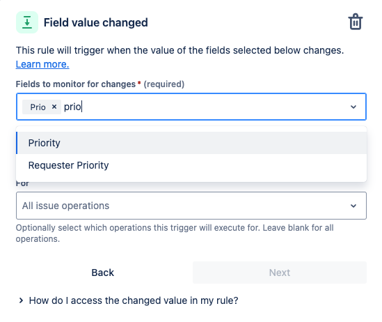

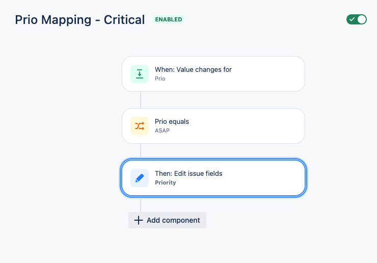

The main issue is, that the Automation does not want to work. It currently looks like this and is created in the Discovery project, where it is triggered, but running into the above mentioned error:
What is the difference in the Automation setting compared to yours?

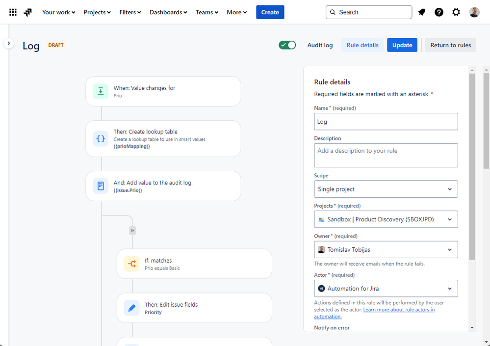

Hmm, there shouldn't be any difference (I'm just using IF/ELSE block but that's it). Also, you can ignore these first two actions after the trigger as I was just testing something out. Can you share how you've configured Edit issue action?

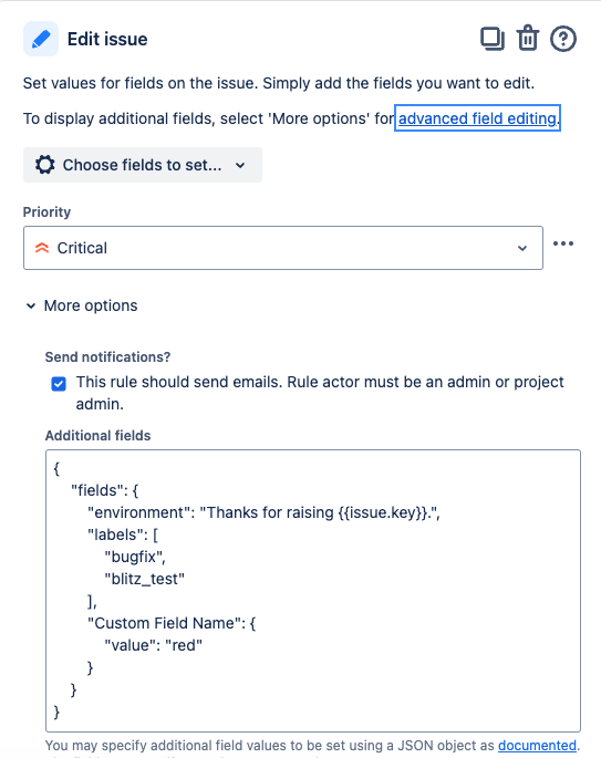

  1. The details of the Edit issue fields action:
    2. I haven't done any changes to the 'more options' part so far.

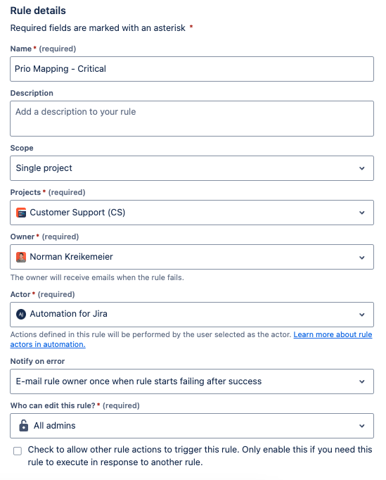

  3. And here you can see a screenshot from the rule details.
    1. It's set as it was initially: Single Project with the JPD, Rule Actor is 'Automation for Jira'. (Not sure if important, but I had to leave the project automations and go the to global automations to see details as scope.
